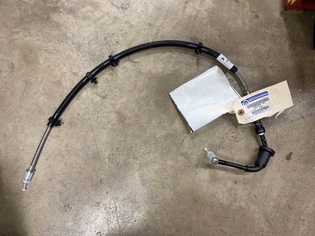

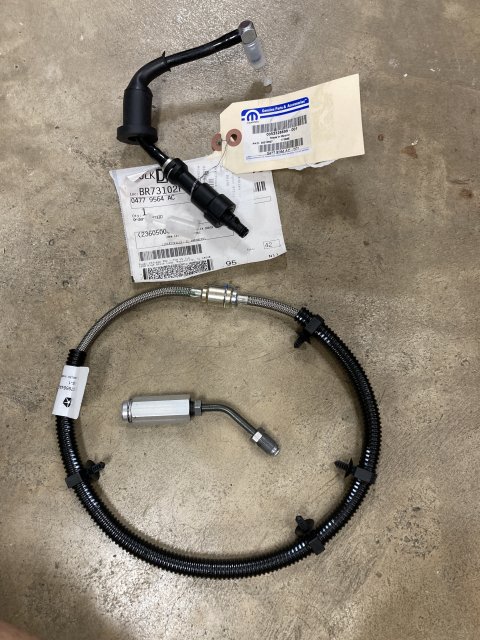

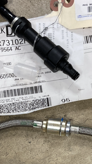

I think you maybe putting it on wrong? It doesn’t go through the holes s as bd out the other side it goes around them then some have white plastic cap to insure clip can not come out. I’ll see if I can find a picture.
3,322
7,856

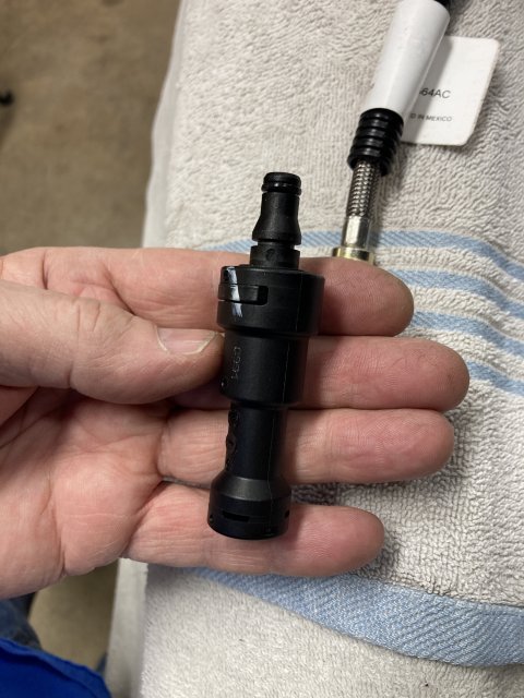

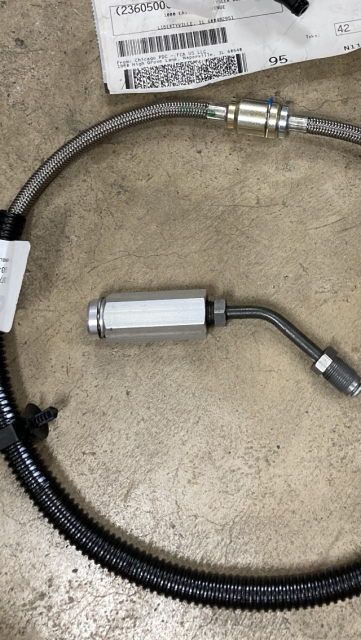

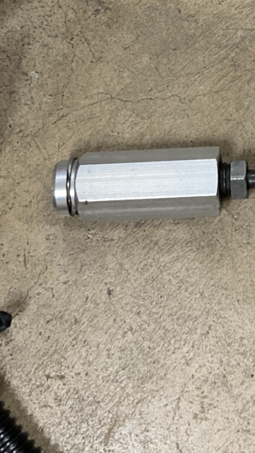

Here ya go, and BTW, the little blue X device is not the clutch delay valve. It is a restrictor to limit speed both in and out, the black device controls flow as well but allows full flow forward and restricts on the return, it’s called a flow check valve. It’s located under the brake booster where the clutch line comes through the firewall.
IMG_8994.png IMG_9541.png IMG_9476.jpeg IMG_9474.jpeg IMG_9540.png IMG_2478.jpeg
The guts can be removed from the black item, and put back in as well. I have Draggy data that shows faster shifts with it gutted. I’ll post if I get time to look for them. I’ve posted this all before if anyone what’s to search my posts to find it, has draggy data and all.

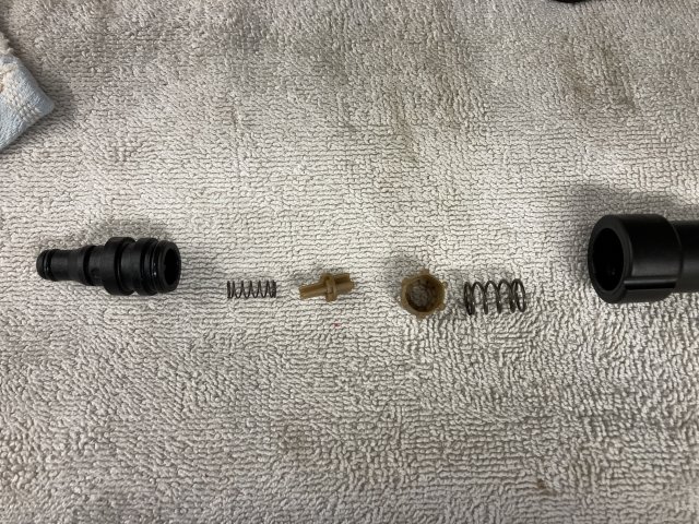

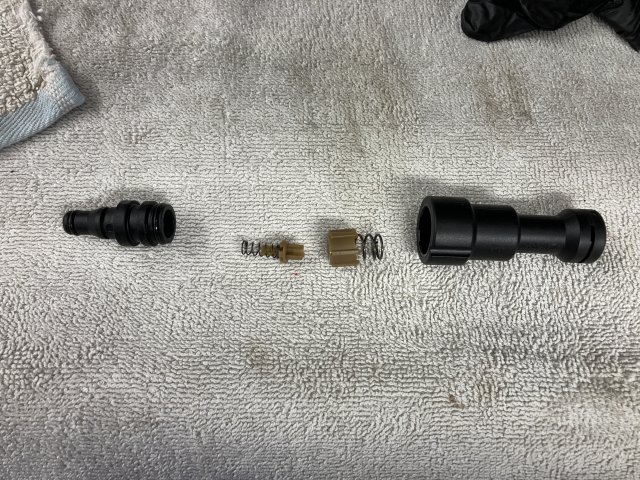

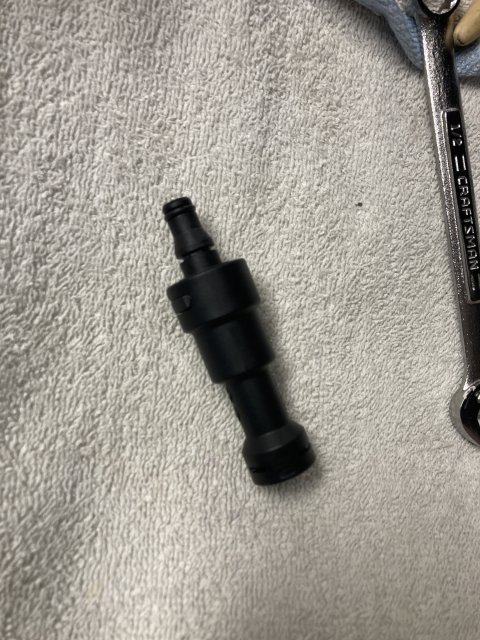

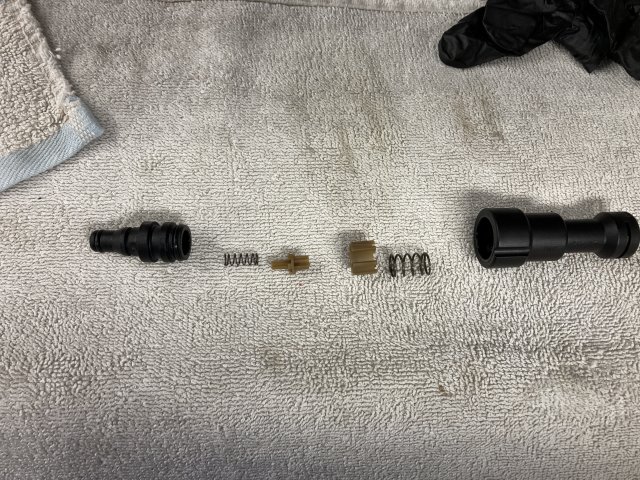

Here’s the guts from inside the black item which is the true Clutch Delay Valve. It’s very easy to take apart and clutch action difference is noticeable when gutted.
