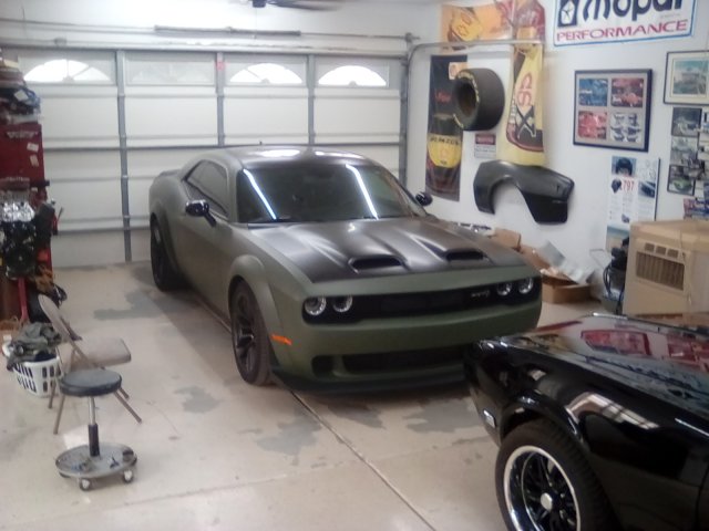

My Redeye is a factory black car with the factory " black graphics package" option. I did a full body wrap at 100 miles. For $3,500
Including wrapping the black graphics, IMG_20200907_131639.jpg hood, roof and trunk.
Very easy to clean, no waxing and no issues.

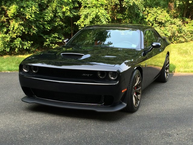

I've posted this pic of my 2015 Phantom Black before. After paint correction and CQuartz ceramic coat it reflected like a mirror.
It was easy to keep clean (especially the wheels!) and made a black car livable.

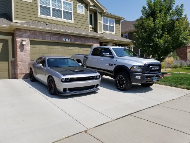

I have the bottom half of the car wrapped along with the front, and then CSL on the upper half.
And mine's not a DD, if it was, I would certainly have the lower wrapped, even with the incredibly low mileage I've got (4700ish over 5 years), I've got impacts in the lower wrap that would make me cry if I didn't have the wrap.
Oh, and I also have the Mopar mudflaps too. They have taken a real beating that has saved even more damage from landing on the paint.
