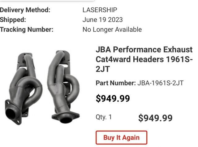

Very well known issue with manifold cracks but especially bolts breaking!! When I did the cam in my Ram I pulled the heads and I had 6 bolts on one side and 5 on the other side that were broken. I got lucky and got all of them out with no issues, but the heads where off. I switched to JBA headers and ARP bolts with factory gaskets, headers are a direct drop in for manifolds with no modifications.
