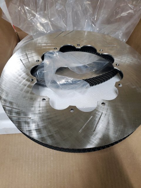

I would very much like to see a picture or two of those (the rust).
I'm developing some new rotors based on my own experience with DP rotors. While I had my own issues with DP rotors, rust was not one of them.
Our current design is based on an Inconel alloy, as such, they will not rust, they are also HALF of the weight, but if the DP rotors were expensive, you won't like ours any better... ; )
Perhaps heavy salt or Mag-Choride exposure?
As for your specific question about RB products, I don't, but I know others on the forum are using them, but I can't speak about their opinion.

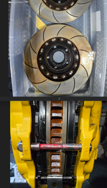

This is what the rotors (front) looked like after I took them off recently to investigate some odd noise I was experiencing.
The hats are indeed aluminum, but whatever alloy/material the rotors are made from don't lend themselves well to rain which is what we get here in eastern WA.
The inner vanes look terrible as does the interface between the rotor and the hats.Soaking the rotors in white vinegar overnight allowed that surface rust to lift right off, and then I cleaned them using Dawn after I abraded the surface and installed new pads.
Some surface corrosion is inevitable on brake discs because that's just the nature of the iron/steel/mystery alloy, but for the price, I was hoping for a little better cosmetic durability with these things.
Note that the retaining bolt is the incorrect spec for these brakes: They were installed by the previous owner and I have since replaced them.
Mine look that way to. They work just fine tho. Does the car sit a lot? Do u drive it often?
I have used these rotors for years. On and off track. Never had a rust problem. Like @BULL says we know of an issue or two but rust has never been one. What pads are you using? What is the red slop on the connector bolt?
Thankfully it's only used for errands and general city/hwy use (no commuting) Sometimes it'll sit for a week or so in the garage. Any surface rust would have been due to rain exposure and washing.
I was using the Girodisc GP10's that came with the package bundle. I don't exactly know what those pads are comprised of, but I do know they were exceptionally dusty. I developed a disturbing clunk recently at low speeds and took the fronts apart to investigate.
Not only did the pads have some vertical slop, but I noticed a pad imprint on the backside of each rotor which makes me think that perhaps I came to a red light when they were hot at some point.
I cleaned/abraded the rotors, installed all new pin/clip/bolt hardware and a set of Hawk Ceramic pads. After bedding them in, clunk was gone and braking is as expected.
The red goo is the grease that came with the Hawk Pads, I figured I'd use it and see how it performs.

It has to be that your pads are the cause. Pads deposit a very thin layer of material on the rotors as well as spray their residue all over our wheels and of course as you see into the other parts of the rotor. You have pads depositing lots of corrosive material all over the place, whatever they are. I have not taken these rotors off this car since 2019. I use Powerstop Z26 on the streets. They allow me to use chrome wheels! Absolutely no dust = no other harmful residue. I use Hawk DTC Pads on the track. This set has seen the track dozens of times. However, that dust is not allowed to get wet and is always washed off quickly. The only rust is a very little mark those pads made after I washed this car in October. Normal, seen those before they alway come out during the first brake. These are bullet proof for the street my friend. They like Powerstops that leave them shiny and clean. The wear in the street is negligible. What you may notice is indeed something these rotors do when subjected to extreme heat during track days. They heat check. That is not desired. I know @BULL well and we have had deep discussions on brakes for that reason, I stand as one of the first in his line when he offers his new version of rotors to the public.
I recommend you simply spend $200 on front and rear Powerstops for the street, clean those up the best you can and enjoy the money you are going to save by NOT changing out your DP rotors. Skip nearly all grease too. A small and I mean small amount of green brake grease may be applied to the backs, but pretend your applying hand lotion. No thicker.
