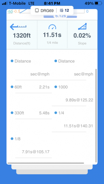

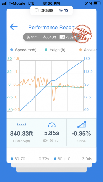

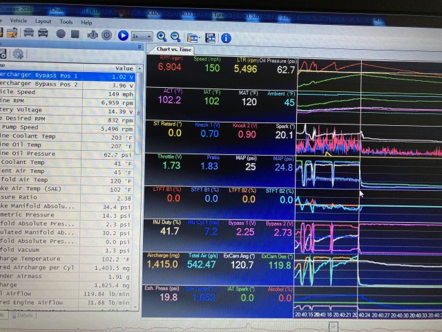

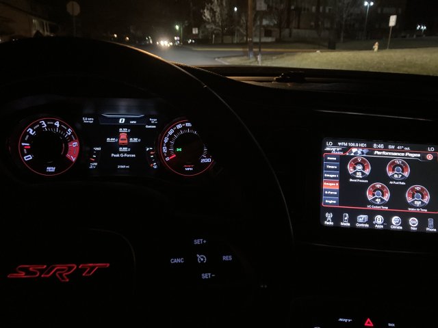

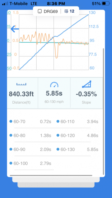

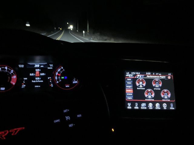

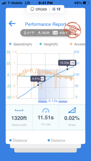

My drag size KC last night, before a 60-130 pass and 5 minutes later 1-2-3-4 1/4 pull to 150 and 5 minutes later my temps again. Notice the time stamps. Coolant started out at 26-28 F and ended in the 40’s. I run a +10 lower and 2.74 upper on my ported 2.4 blower making 21-22 psi. I’m happy with the KC, it’s been running almost 4 years now and I’ve never added anymore Freon or even touched it, or had a problem with it.

Thanks Mike! Some really good data there. I had a KC before, never installed it. I don’t like how they didn’t move the pressure valve, is bad for the compressor because a lot of the refrigerant gets caught up. The IC unit looks great, did everything how it should be, I like how it’s plug and play
