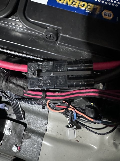

Got it fired up.
easy enough.
the jolt on the car knocked the power plug to the fore fuel bus bar.
it’s now zip tied up.
now she needs a super charger belt
full inspection is showing no damage to the suspension.
one slightly bent exhaust pipe with the passenger tip pushed in. Easy fix
my coolant tank got pushed up and has a bead or a slight puncture somewhere. Have a tiny leak. But that needs to be fixed.
the rest is going to my body guy for minor body repair and paint.
needs at least one new wheel maybe two.
alignment. And fingers crossed she’s as good as new
