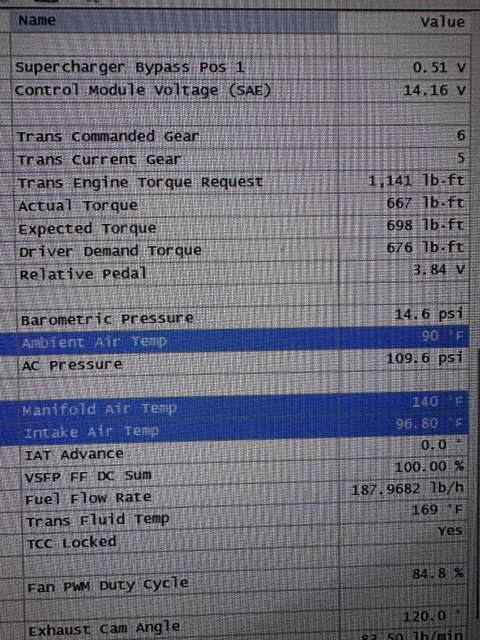

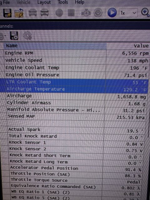

I’m not pulling spark because of IATs anymore on a 90 degree day with the 2.69. It would pull several degrees at the top end before it

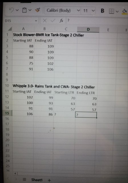

More data is needed. And i wasnt logging IC temps before. But this gives a rough idea. Bare in mind on stock blower, that was 80 degree weather with IC temps reading 30s in the lanes. With the whipple it was also 80 degree weather

Nice, mine with stock blower 2.69 no aux tank and chiller was ending at 96 on a 90 degree day, I believe that was my hot lap as well. The big killer is manifold air temp

Why are your starting LTR numbers so high with the CWA 400 pump? I guess that’s my point, the CWA isn’t needed and can actually cause issues with a chiller, it’s meant more for an ice box in my opinion and even then not needed. Your lower IATs are due to the whipple

My guess i wasbt giving it enough time before next run. Ill get more data and report back.

and here’s the big difference for chiller vs non. No chiller, MAT was 172 - 2+ degrees of spark pulled for the top end of the track. With the chiller, MAT was 144, no spark pulled

If the tuner left the Thermal limits at stock or close to it...it'll start yanking timing and DUMPING boost at around 145 - I found that out during my license passes. It was 95* and starting IAT1 was to the moon. IAT2 (MAT) was creeping over 145 but not every run. When it did I'd see bypass opening and a ton of timing retard. Usually by the 1000ft mark.
But the car was dead ass consistent that way. Like 10.1, 10 000 and 10.05 back to back. Lol
