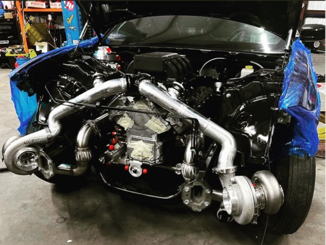

Im looking to do the same with Satera except im looking at a 4l80 vs. a TH400 and either the Holly or the Fueltech 700. Absolutely love the ability to make changes right on ur dam cell phone! I have a bigger ci motor than u at 430ci and its an Aluminum block vs BGE which is living on borrowed time at those power levels imo.
My question is how are u getting away with 76mm Turbo's? I was told that 68mm is the biggest I can go without becoming REALLY laggy on the stree or for roll racingt. This is a roll-race 1/2 mile build for me and the motor and trans can hamdle more than 1800 whp but im told its a TERRIBLE idea to even go with 72mm's nevermind the 76mm's!
This is coming from the guy who has built more Turbo Hellcats than everyone else put together practically.
HHP destroyed (3) BGE blocks last year before switching to the Aluminum with biillet mains. They were making 1500-1600 whp in a REALLY lightweight car but that was with a Blower so much more abuse of course but they state they have not broke one since switching to the Amuinum block which gets ur more CI's btw.
They seem to lite up pretty quick on the dyno tho so IDN what to think now smh. I wanted 76mm's so I could turn it up to 2000-2200 whp cause the 4l80 will handle it but at 411 ci IDN how ur gonna spool that those things on on the street unless this is a dedicated race car and u dont care about that.
You mentioned having the fastest Charger. I think ur a long way out from that bro. Takes a LOT more to go 6.70's then HP. I would be curious to know how it spools up on the street thanx..... I plan on taking this to Drag Week this year.

Thread Starter #19
Our previous build of stock blower and stock bottom end and 200 shot of nitrous; ran 8.7 at ~1500 whp and made over 100 passes on that setup and won tons of events.
Your statements are from a limited source of data and comes from a Hellcat Community and not from the larger Race Community. Hellcat Community is about 5 to 6 years behind the Racing Community. Ford and Chevy have been in the low 6's and might be into the 5's now for their late model cars. Hellcats just got into the 6's this January.
To include, your data source is coming from tuners/shop owners that never used the best ECU software on the market = FuelTech and have never been apart of the racing community.
We made tons of changes (that we're not disclosing at this time) to make this build work just like the racing community.
NOTE....These records are for stock chassis and not full blow tube chassis cars.
Quickest/Fastest Hellcat CHARGER record is at 7.7 and we're going to break that record
Quickest/Fastest Hellcat Challenger is at 6.9
https://www.dodgegarage.com/news/ar...st-srt-hellcat-cars-to-duel-in-las-vegas.html
Jake Sampson built this block and strengthen it to hold 2000+ whp and we did some other things to spin the crank over 8000 rpm.
Rossler built this TH400 to hold 2400 whp but curb weight is critical on failure
Turbo Lag - we need to stop using these cookie cutter TT kits (off the shelf kits) and build custom TT builds like the racing community. Thus you are correct, from a cookie cutter kit the smaller turbos will not lag. But look at the piping and how they route the hot and cold side. Those kits don't make sense for adding more power, larger turbos = lag
See picture below on how to build this 76mm TT: No Lag and watch the FuelTech video; turbos spoil in under 4 seconds for launching the car
76mm Harts Turbo - we selected Harts 76mm because we do not want to stress the turbos at 99% to make the power. Thus we're using larger turbos and only racing at 60% capacity of the turbo. Thus limiting parts failure and longer life.

I think what he is trying to say. If it took you 1500hp to run an 8.7 adding even 300hp more isn't going to get you into the 6s. Even with the fuel tech computer and its capabilities. The transmission will help you.
Really nice build. I am sure you will be the fastest hellcat charger. This thing is going to be a monster. My comment above does not take that away from it. Keep us posted of the progress it makes and your experiences.
