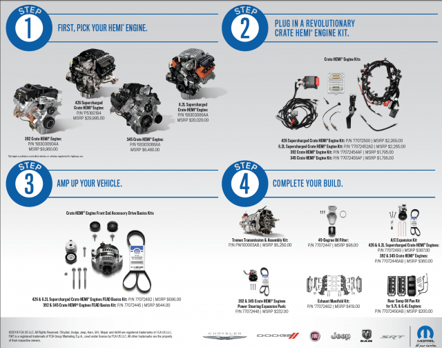

Don't know if this helps but has some part numbers you might need..

Wondering if the 6.2 is the redeye engine. It has the black block like the demon and not the orange one of original hellcat.
