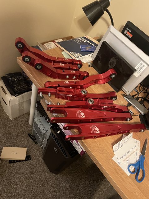

Now it's my turn lol. Installing this today.
49,957
161,123
You bought those pretty red ones that will clash with the rest of your car. They would have matched my interior:unsure:
3,575
8,704
I'll spray paint them black before I put them on, say goodbye to the red.
49,957
161,123
Good luck on install. I'm sure at some point I will be buying these. You doing anything with cradle bushings since you are dropping it?
