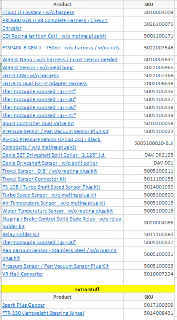

Good call out and FuelTech already has my build sheet for a Gen 3 Hemi and what's needed to order and install for the FT600.
Here is the catch. Not everyone buys all of the sensors. We wanted all of the sensors. LOL! More data your tuner has, the better he/she can tune your car.
Basic must haves sensors:
1. Oil Pressure
2. Fuel Pressure
3. Water Temp
4. Trans dumps (internal and external)
5. Crank case pressure
6. Driveshaft - must have in racing
7. MAP
8. Knock
Added sensors:
9. Turbo speed
10. Ride Height
11. Wheel speed
12. IAT
13. Pan vacuum
14. I know I'm forgetting some sensors...LOL!
Here is the list of my complete FuelTech FT600 kit:
We bought the remade wiring harness and then built our own sensor harnesses. Some of the basic sensors are in the FuelTech wiring harnesses.
