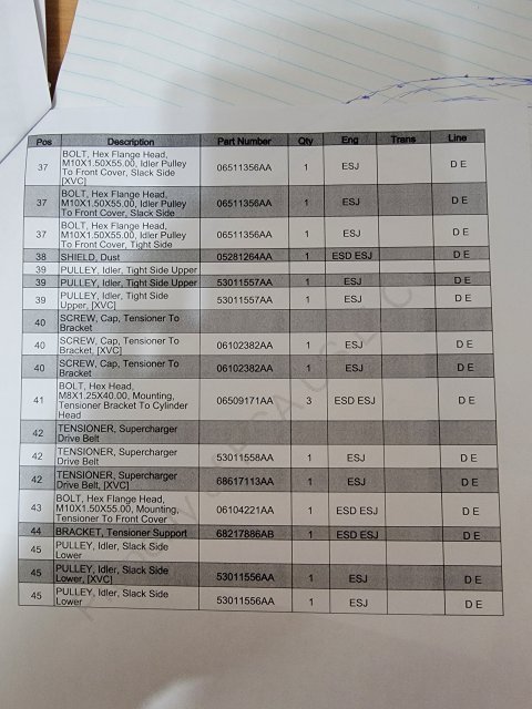

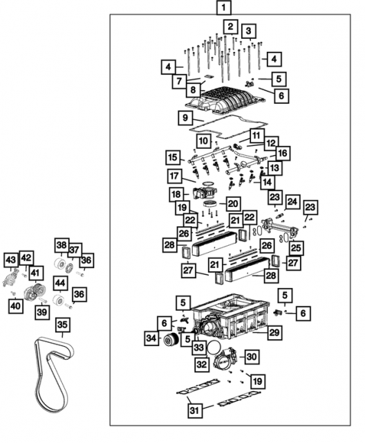

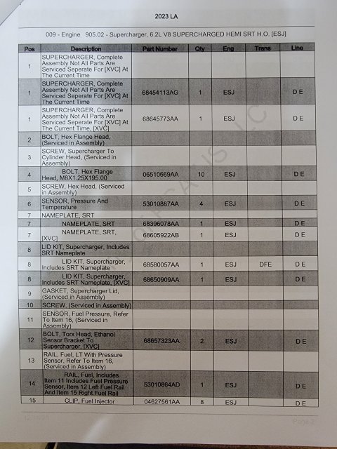

Like I said they only service the supercharger as a complete unit or you may be able to buy all the needed parts of it individually and assemble it yourself.
However from what I see on the list of parts most of it is only serviced as a complete unit.
All you have to do is use your phone and call your local dealer like I do, or do you need someone else to do that for you because it is too complicated. lol
Below is the drawing and list that the dealer see's when he looks up the supercharger for the D170.

So if this is the 170 supercharger where’s the flex fuel sensor? Just curious

Right now the sensor is not a normally available service part.
It is on the fuel rail right where the nipple is that the fuel line from the tank gets slipped onto.
The dealer can, if it has to replace one on a D170, do a special request for it under warranty but only for a D170 which the dealer would need to give corpret a valid V.I.N. and also return the failed sensor to corpred so they can find out what went wrong with it.
After Decmember 31st, or sometime there after when production ends, more parts from the D170 supercharger and other parts from the rest of the car will become available by themselves.
Some parts may hit Direct Connection later and in some cases it will be for a lower price then if you bought the same parts through the dealer using the normal ordering method.
