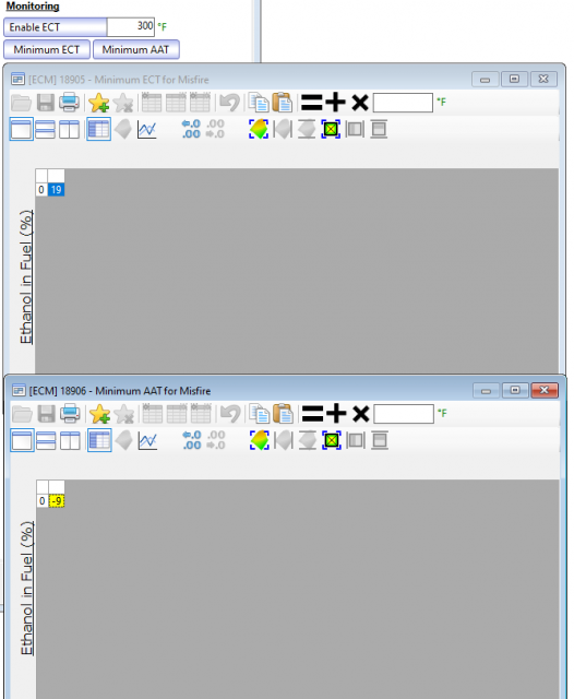

Raised temps to 300F, definitely not seeing this temperature. For some reason the labels in the table are not correct, wonder if this is an issue.
If anyone can help it would be appreciated. Kinda at my wits end...
