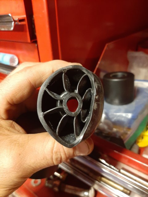

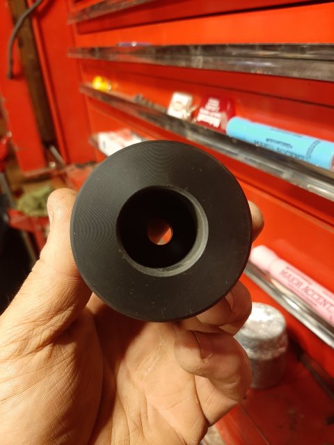

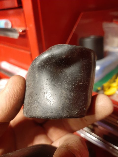

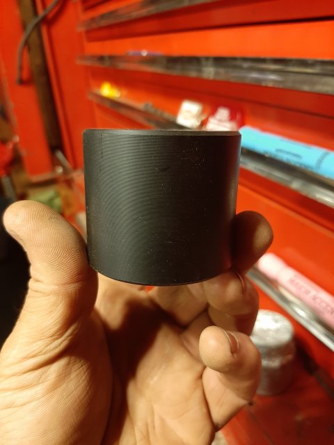

Yeah. Thanks FCA.
Bigger thanks to Lift Pad Pros for the HD Delrin replacements.
Some may view them as pricey for 37 bucks shipped but after a cursory Google search they're about all that comes up. They look to be worth it though. Mine took a dump as you can see and I'll only have my jack on drag week since I'm not taking the quickjacks. With that many tire swaps in 5 days I'll definitely have a followup opinion on these.

I like it, however I would like to see a bigger chamfer or radius on the bottom.
If mine ever give up I'll try to remember these.
BTW, Delrin isn't cheap so keep that in mind.

WTF? I only use those spots to lift the rear as my floor jack point. Are those replacements the ONLY name in the game? Geez, never heard of them falling… last shit I need when I’m under there.
Assuming you can get a long socket in there to replace while on ground?

It CAN be done on the ground but I did mine while it was on the quickjacks. Should just be a single deep 12mm socket if I remember right. It also sits on and helps to hold on a plastic trim piece. It should stay put on its own. It may or may not have a metal washer meant to help hold the bolt in place for installation. If it won't fall off the car once loose the washer is probably on the top side of the plastic which will unclip and come off easily so you can remove it. You'll see what I mean once you're under there.
