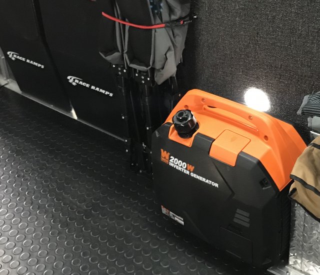

Charger for the track runs off of?

Interesting

I'm waiting to see if the battery can be charged sufficiently between runs with that charger.
