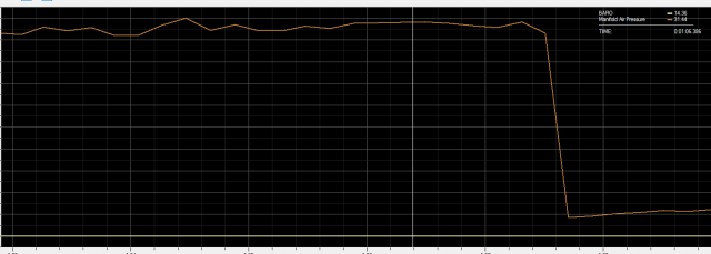

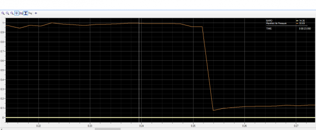

I hope I don't come off dumb with this post. I'm looking for help here and I am concerned since I bought the car used and don’t know it’s history
From what I understand from online research and watching Speedys youtube video is Boost is measured Manifold Air Pressure - Baro.
I only have a 2.85 pulley how am I making this much boost.
This would be 16.33psi DA was +800
This screenshot was -400 da but still 17.61psi on only a 2.85

for hp tuners i start log with the key in run to get the baro
1 MAP (kpa) = 0.145038 psi
then subtract the baro
looks like your map is already in psi

Yes map is already in psi.
I did not start the log with the key in run. Do you think that would make that much difference?
Baro seems to be about right.

It does seem about right, mines usually about 14.4-14.8

i just don’t understand why I’m making that much boost.
i just had it email tuned and the tuner ended up pulling some more timing than expected but we thought it was just bad fuel. I even put octane booster in and it wasn’t enough. I’m wondering now if it was because I was making so much more boost than expected.

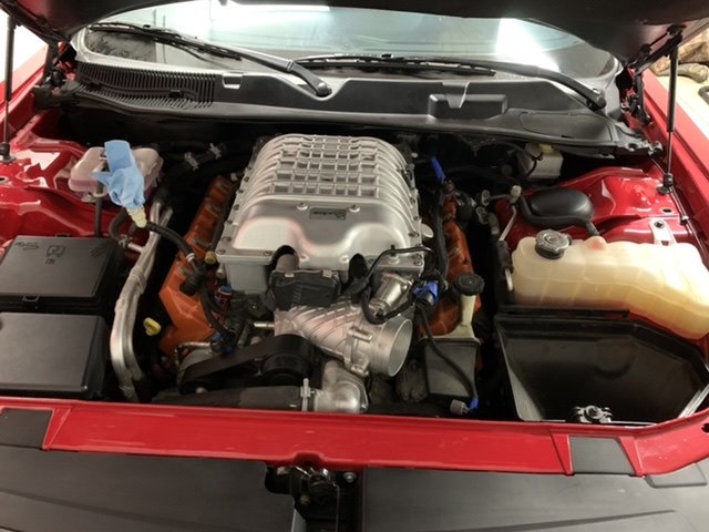

Does your car have a bigger throttle body or ported blower?

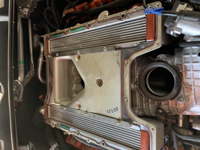

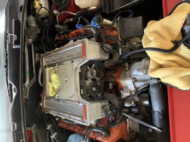

I wish I would have paid more attention when I pulled it apart over winter. Not that I’m aware of. But the cars used so maybe it was at some point. At first I was worried about a lower but i don’t believe that was it. I was talking to the wife about it this morning and said maybe it’s ported. I guess what would be the best way for me to tell if it is ported ?

5FC3BC2B-ACEC-41B3-953A-BD87E9790DE1.jpeg 7DFC87E5-9818-46B9-B32B-62F0EBE920C4.jpeg 5A68A0DD-BFDB-4A54-823A-22FCF2F47D47.jpeg

I took those pictures but that prolly doesn’t help much.
I would say looks stock.
you would know, much smoother like this
https://www.dusterhofftuning.com/products/jokerz-hellcat-supercharger-porting-service

Is this the first time you ran it in DA that low?
I presume it was colder and dry air with the baro quite high.
