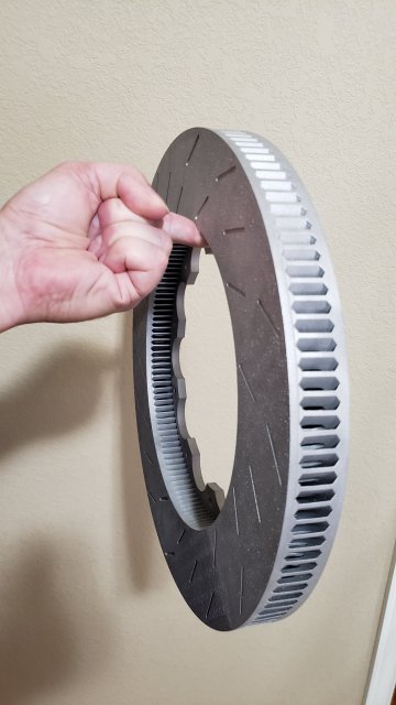

Wondering what the weight difference between the two are. Demon rotors are pretty dam light. Wondering if the $16k is worth the reduced weight that carbon offers.

By itself no way would I buy them but ive done like everything I can think off to lose weight for my Trackhawk so im just wonder what the actual weight difference is.Front Cemon Rotors weigh 24 lbs. which is 7 lbs lighter than stock at 31 lbs. I assume its the same or close on the Hellcat.
I got like $250k into my Trackhawk so its more like 3% of the vehicle value lol. Whipple came off. New build under way.

From what ive discovered:
Stock Front Rotor: 31 lbs.
Stock Rear Rotor: 24 lbs. 110 lbs. of rotating mass.
Demon Performance Front Rotor: 24 lbs. (7 lb Difference vs. Stock)
Demon performance Rear Rotor: 19 lbs. (5 lb Difference vs. Stock). 86 lbs of rotating mass. 24 lbs of rotating mass reduced over stock.
Carbon Ceramic Front Rotor: 15 lbs. (16 lb Difference vs. Stock and 9 lb Difference over DP)
Carbon Ceramic Rear Rotor: 12 lbs. (14 lb Difference vs. Stock and 9 lb Difference over DP) 54 lbs of rotating mass. 56 lbs of rotating mass removed over stock
So u can clearly see the weight advantage with carbon vs. the DP rotors is greater than the weight difference between the DP rotors and stock.
Thats about 28 lbs of rotating mass..... Thats a lot. I have the DP rotors on my Trackhawk and Redeye ive done everything I can think of for weight reduction so im considering the carbons now. They seem to be woth the extra money at 28 lbs of rotating mass removed.
Thats about 150 lbs of dead weight removed. Of course its not the first thing I would do to remove weight its clearly the LAST thing ppl should do imo but considering stocks weigh TWICE as much its a good mod imo.
I just put them on my Redeye and the car clearly leaves harder from a roll now. Thats fact. Also brakes better and handles bette. Put them on Trackhawk as soon as I bought so I compare the two there. My Turbo Mustang has em as well.
You loose a significant amount of unsprung weight just with the DP rotors (made by Girodisc). The additional amount WTF ever it is will not be worth over $13k!! I use them and they are rock solid and tough. If you have a Porsche WITHOUT the dumb ceramics, you have the very same rotors!

WOW would not have thought they would be less than 1/2 the weight of stock!!!:eek:

I know thats like removing 200-225 lbs of dead weight! Probaby more!

At that point I would put skinnies on the track hawk up front and lock it in RWD mode. Less money, same impact. I removed 32lbs per side up front switching the front runners
