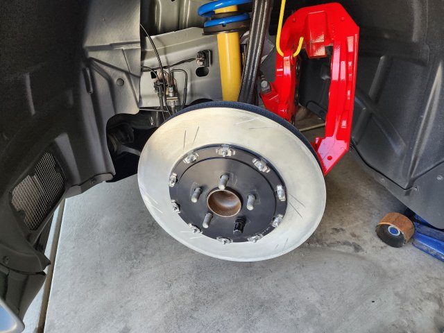

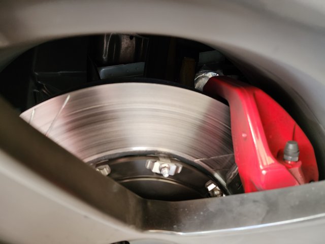

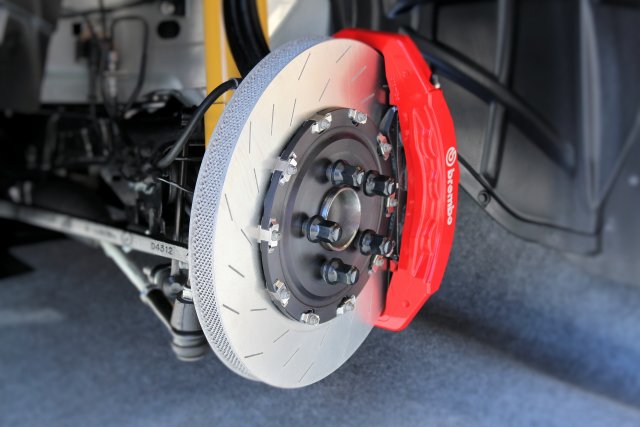

(A couple of on-car shots of two different iterations)
Ultimately, our original A1000-RAM10 material, was not fully compatible with "off the shelf" pad linings. We were working with a few different pad manufacturers, but ultimately our focus was on the rotor and being able to provide a solution to the broader market, not one that required a specific and "only" pad material.​
Earlier, "coatings" were mentioned. One of these coatings was a nickel based "cold-spray" application, and this was very promising, but had adhesion issues. As a result, it was scrapped from development, but we never forgot the initial performance realized in this design iteration. Pad CoF (Coefficient of Friction) was very good!​

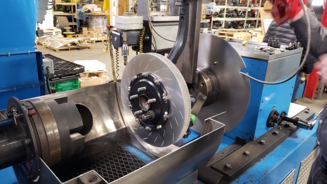

3D printing is at the heart of this design challenge, it allows for a heat-exchanger design (really what a brake rotor is) that can not be cast due to internal channels and paths, as well as what is generally referred to as "thin-wall" features. In a simplified way, these features are the basis for our patent. This is what makes this rotor so much better, it's ability to dissipate heat energy. All materials have various thermal properties, and among other reasons, this is why we initially chose the A1000-RAM series material. The thermal conductivity is very high. The initial A1000 designs that went to Detroit to be tested, on the same brake-dynos that the Big-Three use, performed so well that the technicians had to dramatically shorten the dwell time between test sections because the rotor was cooling off so much faster than they were used to!​

Those fender wells seem to clean for a test car 😉
CDT Rotors
CDT Rotors
#2049
98
321
Frederick
Challenger Hellcat
Thread Starter #16
He can be a bit OCD
