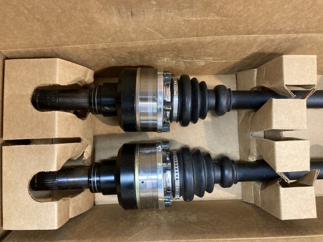

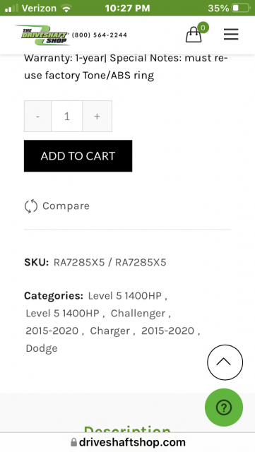

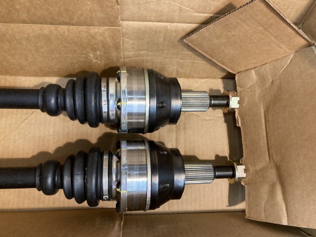

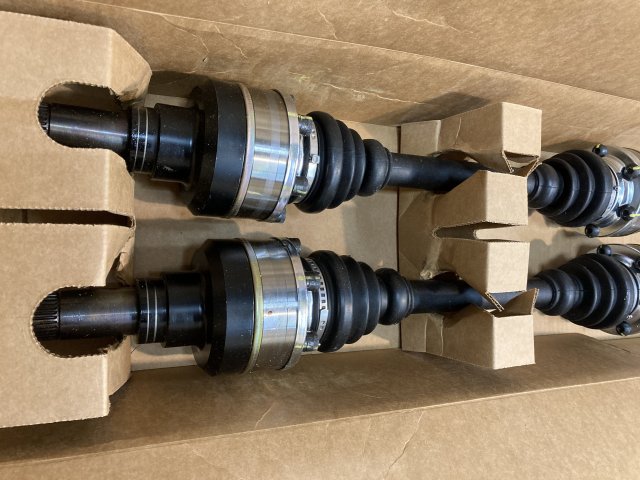

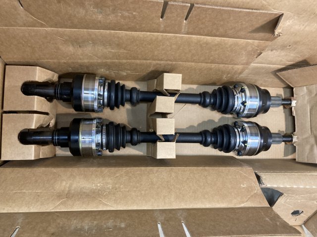

DSS Stage 5 axles are same part number left and right, RA7285X5, ie, there is no left or right, they are exactly the same as one another and can go in either side. I’ve had 3 sets of them already. Unless they have something new out?? 22A5CA0E-FD48-4246-9BAC-BA5D43D0FDF1.jpeg CC8649B9-0A2C-4091-9E7D-0C86454FFCB6.jpeg 3F944F44-210B-4230-BF03-1B73A8D51FB0.jpeg 44CFBF57-1DD7-4D72-AC94-E728E552A9BE.jpeg 8862E3B8-AD75-4461-BD20-6B044751710A.png
