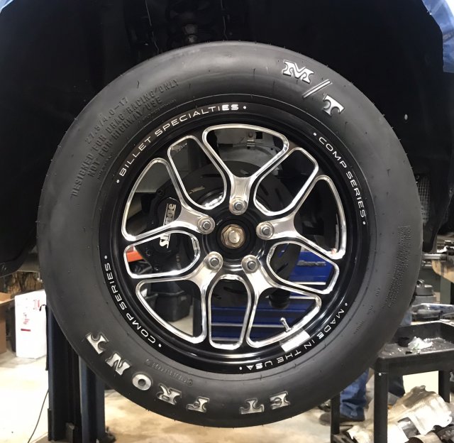

Their maximum load at 50 psi is 1140. Multiply that by four and add a 200 pound man are they suitable for a fully weighted hellcat at the strip. I am talking about the 28 inch ones for an 18 inch wheel. Radials. They do make a street version at 25 pounds a piece.

Sounds like you're not leaving much of a safety margine. 1140x2=2280lbs. Let assume your car, with you in it, has a front weight of 2280lbs or slightly less. I can't answer this for sure cause I have not put mine on my scales yet. Are you still good? Your car sitting with you in is not 50/50 front to rear distribution. How much weight shifts to the front tires when braking at the track? Willing to bet you will exceed the weight rating of those front tires. But what could go wrong with under rated tires at over 140mph?
Believe me, I thought about this because you are right, the street radials are a very heavy tire compared to the race ones I use on my other two race cars. However, they are rated at 1650lbs each. I just didn't feel the weight savings was worth the risk. Remember, there is another racer in the other lane. Sorry for the soapbox. Good luck and be safe!

I have the Hoosiers now. But at only 12 pounds a piece and bias ply they wander at over 140 mph. That is why I was inquiring about the radial MTs. But their weight handling does not seem to suit our heavy car. So I totally agree with you. I have a feeling the street variety will only slow the car down a few hundredths. Because of the radial construction it will have less rolling resistance than the much lighter Hoosier. And I bet it will feel a lot more stable and safer for the driver and as you stated the guy/gal next to you. So I believe you are right on and have valid points/concerns.

Yea. They know that the modern muscle cars are heavy and that LT rating brings weight. If you are still on the street then the weight is worth it. These things match the ET-R rears and they say that they are designed to go with those. I have no experience with them so can’t say how they might perform on the street. The Sportsman's are great.
Yes I run them I drive to and from track on them just did today.
5,657
4,687
They’re way lighter than 25 a piece.

The newer ones are 25.3 pounds a piece. And very slightly wider.
5,657
4,687
Well, maybe. I forget. My 18x6 forgestar f14 skinnies with that same tire weigh 32lbs
5,657
4,687
Strange, mine have the same weight rating and psi. Sure it’s not the same tire? 28x6. Mine were made in march of this year. Et street front
