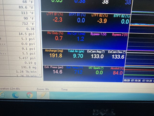

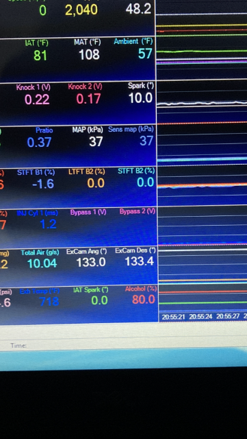

Car seems to be calculating E% better. Been mixing in 99% E and it’s reacted pretty appropriately with each addition.
Was at 77% added 5 gal of 99 to 13 gallons and went to 80%. Added 5 gallons again last night which took it right up into the filler neck and now reading 84%. Garage party tonight at my buddies Dyno shop, pretty much the same timing map as prior run, I’d be happy if she made 925 HP again and 800 tq this time with more E. Hell, I’ll be happy to just drive her home afterwards!! 🤞

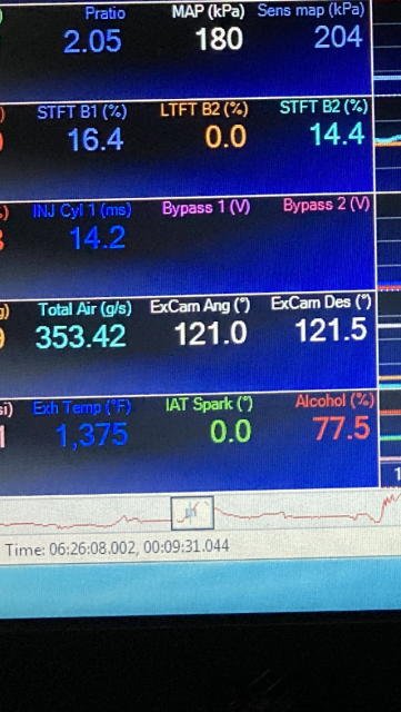

Quick question to those running flex fuel. When running ethanol fuel are your fuel trims positive? On mine with the flex fuel tune installed when I run 93 my fuel trims are within +/- like 3-5% give or take. As ethanol is added the fuel trims start to go positive and the alcohol content in the log rises. On full E85 the trims are like +25(ish)%. Ya'lls work the same?
I'm assuming that's how the car knows how much ethanol is in the fuel, as the trims go positive it increases fueling through the alcohol multi tables the proper amount, but the trims remain positive since there isn't a separate injector scale table for ethanol.

Idle and cruise mine settles around +/_ 3% but WOT it will go up to 20-30% . Positive . I ran out of time to fine tune it .

I hadn't reloaded a gasoline only tune in many weeks and my logs cruising around showed +10ish % STFT and +6%ish LTFT. WOT was almost +30% STFT and 0% LTFT.
Must be working as expected. I thought maybe my trims were off.

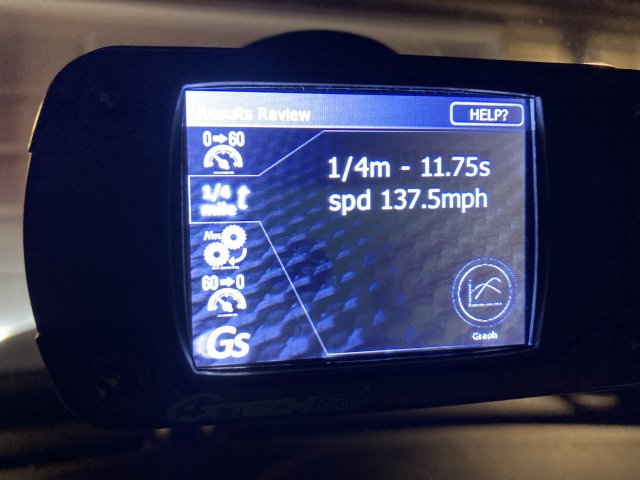

Here’s a dyno video from Thursday night, loaded a tune mod right before the party, car recalculated E% to a lower figure, didn’t develops full boost for some reason, was 2 lbs shy, aircharge low by 150 mg, only got to 17 degrees of timing instead of 19 but still put down 901, second pull was 910. 2 weeks prior on a milder tune put down 935. On the way home ran like never before, put down a 140.6 1/4 on cold pavement. Highway was dead, came to a dead stop on I81 and nailed it. That would have probably been 950+ on the dyno. I still haven’t figured out why the pulls just 2 hours prior where different?? That run according to the log made full boost, 17.8 psi, 1940 air charge and 19 degrees of timing. A 1/4 right after 4 more miles down the road netted 137.5 I LOVE corn!!

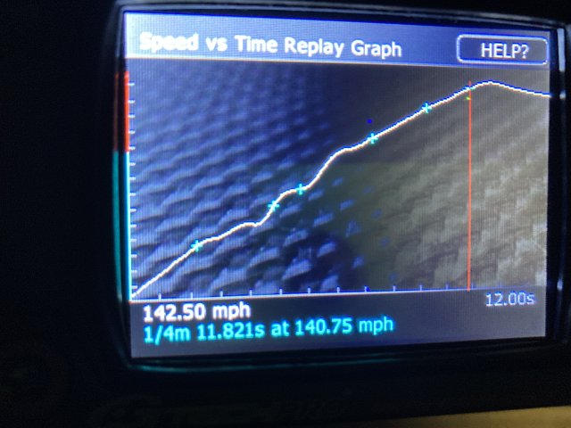

Look at the graph, was spinning in every gear including 4th at the1/8th mile lol. Every dip is a shift and spinning. I just put new Nitto 315 555 R2’s on the day prior. They hooked better then my bald NT05R’s finally
