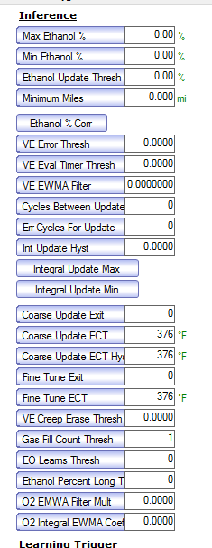

If you are looking to try and tune yourself. Start with 93. No added boost. Get a feel for things. Then add injectors. Tune those in and then go from there. You could also play around with your stock injectors a bit if you were looking to practice.
There are a few of us on here that take on this challenge. But this just isn't something you are going to figure out in 5 or 10 hours. You are going to have numerous hours into trial and error depending on how crazy you plan on going.

4,261
10,592
Here are a few pictures of a non flex tune so no values are entered. But maybe this will help give an idea of just a tiny part of what is required to make the flex work.
