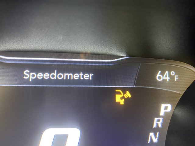

Ever since I got this light on my dash when I put the pedal to the metal it makes the engine cough and die. It does not stall. Are these two items related? Now that I’m thinking of it I have 5 gallon e85 canisters in my garage. I filled her up a few days ago where the e85 was coming out of the neck. By the neck is the evap system. I bet I filled the evap system with e85 and not vapors. So when I put the pedal to the metal it is probably flooding the engine?

It is ok. I never knew I had it either. But Tony the service manager at Chrysler jeep thinks that is what I did. He states it happens on the grand Cherokee all the time when people keep clicking the fuel handle to get every drop they can put in their tank. I think it is not the fuel cap. But what I just stated. I will know Tuesday.

I thought maybe something was being tried as an experiment or the jug slipped or something. For what its worth, I think you're right, the vapor evacuation system is probably throwing a flag and causing havoc.
