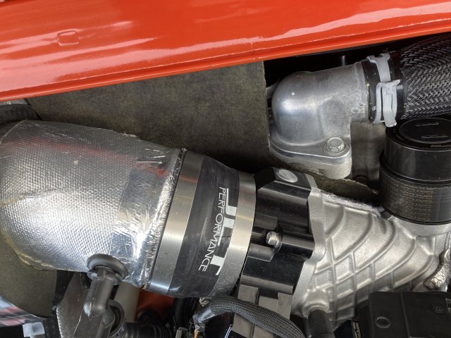

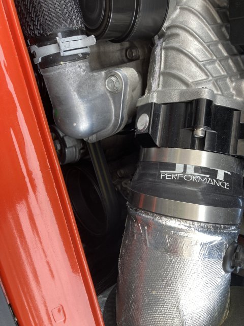

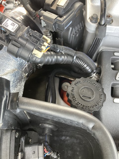

Here’s something I did to keep intake pipe and TB away from the hot air of the radiator fan, lowered my IAT by 15-20 degrees, the intake pipe and TB stay cool now. I can make them but the insulating material Pyrol is expensive and a bit hard to get ahold of. Snaps in place under the brake lines. I’ve made them for hyd power steering and no hyd power pump Challengers. C2B60DB0-2BEC-45A8-8E61-AFE52AB29AE7.jpeg 94ECF551-A0E8-4E0C-A6FC-0AD650BC8E32.jpeg 010346FE-7513-42AB-B435-E1C77F2FA27E.jpeg 9B521EBE-FA97-47F8-B5ED-CA81E4E882FF.jpeg

Here’s something I did to keep intake pipe and TB away from the hot air of the radiator fan, lowered my IAT by 15-20 degrees, the intake pipe and TB stay cool now. I can make them but the insulating material Pyrol is expensive and a bit hard to get ahold of. Snaps in place under the brake lines. I’ve made them for hyd power steering and no hyd power pump Challengers. View attachment 60321 View attachment 60322 View attachment 60323 View attachment 60324
It's hard for me to tell exactly what you've done there?
3,320
7,835
Yea, hard to see it installed, it’s a heat shield under the intake pipe from air cleaner box to under the inlet snout behind the pulley. Keeps the hot air from the radiator from blowing directly on the intake tube and underside of the snout. Top side is painted flat black with high heat paint. It’s slick, stays in place and can be pulled out when needed in seconds
