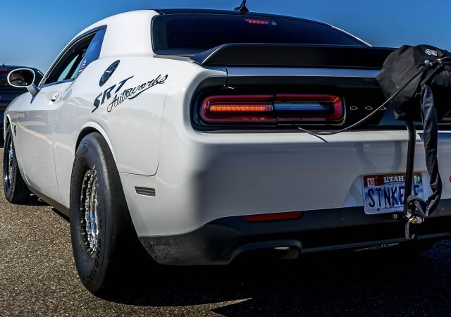

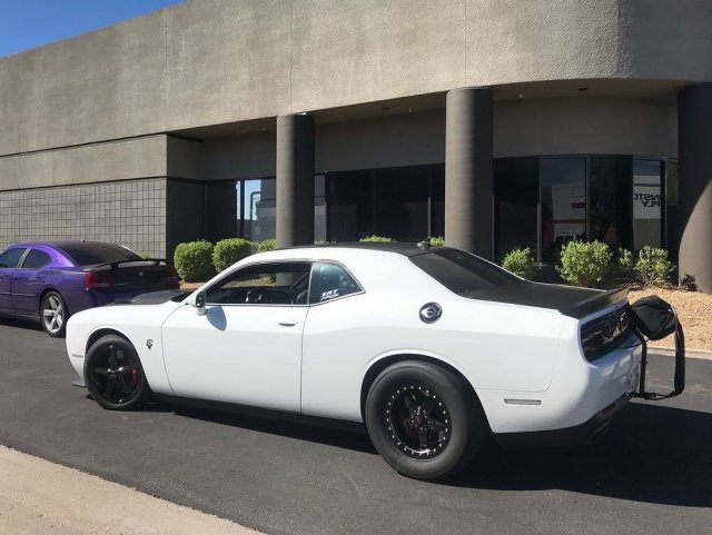

Are those the Devil flares? If so I like them. Woulda looked good on a regular body Demon 170.
5,580
4,613
Yep, paint matched. Had the fronts on too but took them off
Agreed…interested if anyone will had the Devil flares to the front of their 170. The small flare would lessen the difference between the non-flared front and wide flared rear.

Do they wrap around the fender opening at the bottom, in turn allowing for less travel? I noticed my 315/60/15s rub on the fender lip under certain circumstances, it doesn't seem like they do at launch though but with more power at launch, I'm worried they will. I have been considering the same flares as you or just going to the full widebody flares and fender liners on the rear to tuck the tire.
If anyone wants to I have a set of fronts for sale but their paint matched to my car
