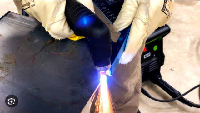

Had same problem with mine. Use the mechanical key to unlock the door and carefully open it. Even though the window does not drop it will move the rubber enough to open. Once inside the car fold the rear seat down and crawl in the trunk and pull the plastic trunk release to pop the lid. An alternative method involves using a plasma cutter to create an access port in the top of the trunk lid, but that's too time consuming for most guys.

Another option

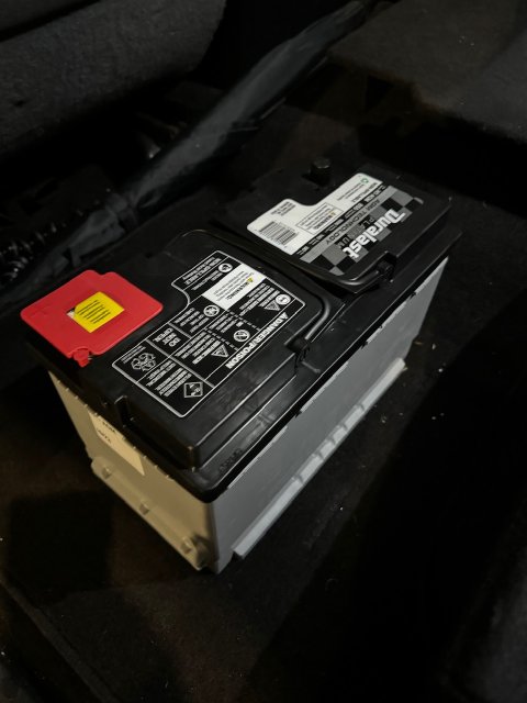

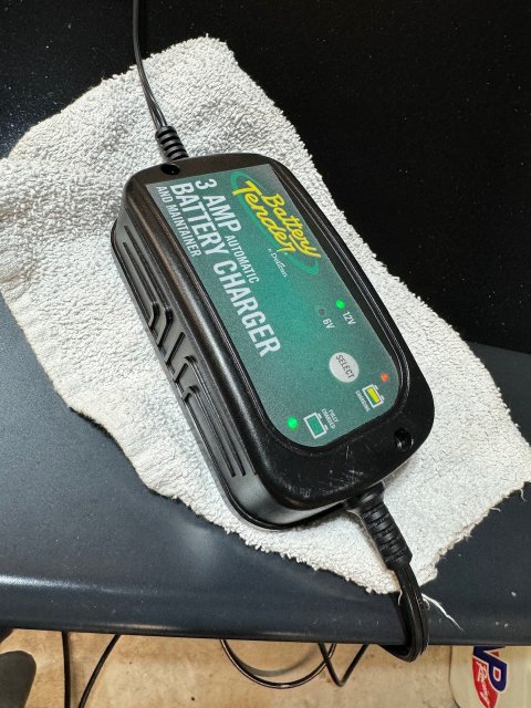

Turns out my culprit was a tazer and mpvi 2 plugged in. Need that obd 2 cable with a switch. Under warranty thank god.
Tender is now permanently attached
