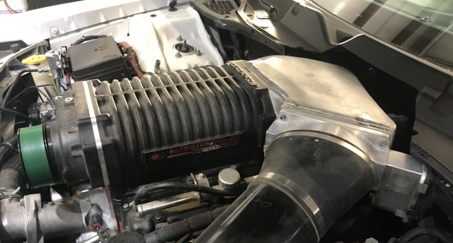

Spacer to increase plenum volume and some minor tweaking to the intake and they work great. 😝 BA23463E-8F1E-4018-BA9A-F2D4C2968F52.jpeg

Spacer to increase plenum volume and some minor tweaking to the intake and they work great. 😝 View attachment 105849
I wanted to do this to mine for the rear plenum, saw it on a green challenger hellcat years ago
5,609
4,639
Shouldn’t have to modify a $7k blower/throttle body though
