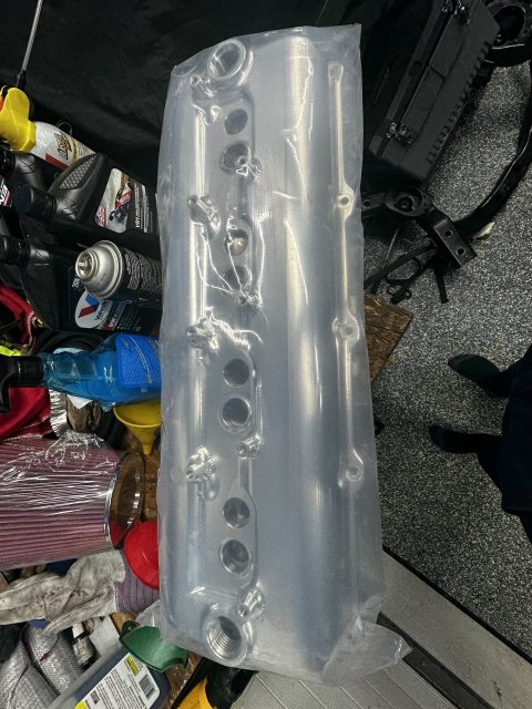

Manton new valve covers fit like a glove.

use factory gaskets ready to bolt on. Can’t ask for a better product for the price.
don’t buy the copies buy the original

Pretty sure I think we discussed this. Mine fit no problem, little tight on install but after that easy day.

@RGPIII the Mantons are the only confirmed fit for 6.2 Hellcats with a power steering pump otherwise you need to eliminate it.

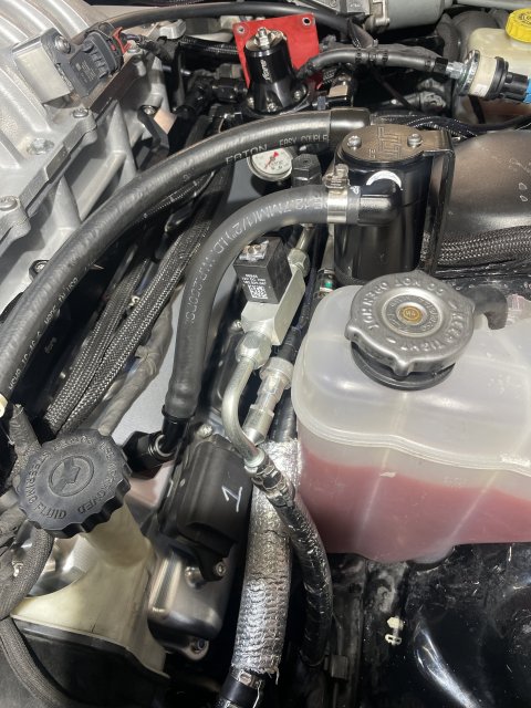

Weld a 10 a fitting to pump and put on a remote tank. That’s how the old 6.1’s are

yup, could just buy the 6.1 pimp and use a remote reservoir. I got it modified to work with my power steering.

Yep, exactly. I’m selling a hellcat pump with a remote fitting on it, not a 6.1 pump. Tank is from a 6.1 or 6.4, has the correct feed and return port sizes that will work with hellcat lines.

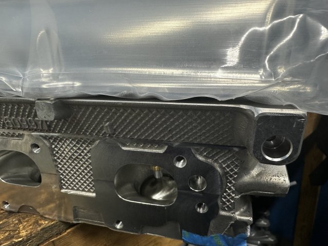

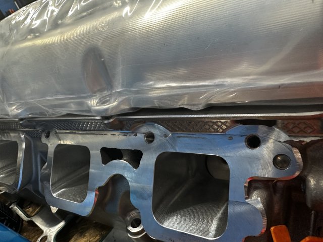

I had to modify my new Cornerstone covers to work with the power steering. I haven't seen any kits to eliminate the power steering on a hellcat yet.
Robert, What portion specifically had to be modified? I have the Cornerstone covers but no plans to have HHP install them until the new block is finalized.
Any pics of what had to be changed?
RGPIII
#983
1,016
1,887
Bridgeville
DE
the front edge needs to be milled down pretty significantly. I've got the 6.1 pump and remote reservoir ordered.
