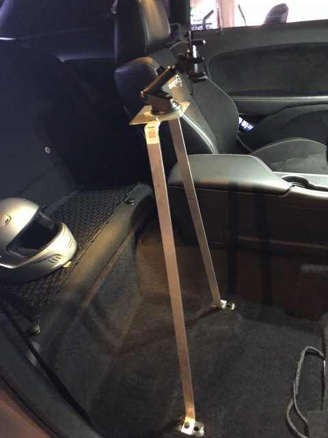

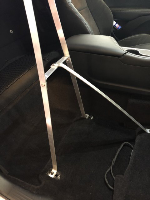

As the title says, it's something that I came up with & made to video my Performance Pages gauges when at the track, b4, during & after each pass to see how things look, since I always pull my front pass. seat for the track it's a good place for this Tripod mount. I don't data log so this is my data logging, lol. It's tall enough to also video out the windshield if I want. It came out pretty nice & study, I haven't done a test drive yet or to the track but soon. It's 1" aluminum flat bar, 4" x 4" top ss plate, some cutting, bending & drilling, bolt it together. I used the factory seat bolts to bolt it down.
Let me know what yall think ?

Impressive. Did you consider using shock absorbing mounts? The hard mounts will vibrate like crazy.

Awesome job. Looks professional. Creative and nice workmanship. I bet it would look even better if you could have the parts anodized to the color of your choice. Other multiple benefits:
1. Another good reason to not have a passenger
2. Possible additional cup holders can be mounted
3. Patent it and sell the rights to Weathertech
Well, points 2 and 3 may not fly?
No, I wasn't aware of this, I've put the suction cup phone mount on the door glass with no vibration, but didn't have a good angle to vid the guages. So we'll see how this does ?
Total cost for me was $25 so no big lost either way.

Great set up! That is going to get some good shots.

Good points, the hardest part is making the first one, now it can be copied.

I thought about making it a quad mount, but not sure if it would be any more solid & didn't want to take up all the floor space for other stuff if needed.

Good looking stuff! I mount mine to the windshield with a suction now and hard stuck it there before. The vibration is not bad, so it should not be too bad mounting there either IMO.

It's a cool set-up, but I think you are going to have vibration issues unless the tripod or camera mounts are 'soft'.
Unless of course your camera is self stabilizing ;), in which case - never mind :)
Something like this will likely fix it:
https://www.amazon.com/GoolRC-Gimbal-Vibration-Phantom-Walkera/dp/B00NSF79EO

Well I did a street test drive with the iPhone camera mount & viewing it normally it looks ok but when I zoom in, then I can see vibration, streets not the smoothest. Maybe the track will be a little smoother, or will need different mount or camera.
