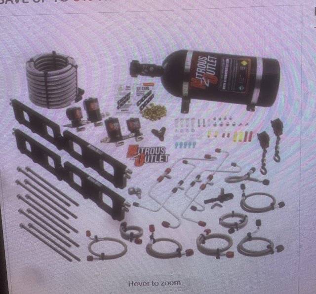

Alright, so considering nitrous. Probably 130 jets. Spacer kit. Don’t want to spin the blower any faster 2.69 upper. Thoughts? Will she handle it? Pros? Cons? Send it? Thanks guys, looking for some honest, solid advice and opinions here. Thanks

Add a lower pulley or port the blower, or both before going nitrous IMO. Ported blower and lower pulley is good for around 100whp

I don’t want to spin it any faster, which a lower would do. Maybe a different snout and throttle body, looking to see what everyone’s experience is with nitrous

You can buy a supercharger lid with a spray bar.

They have a real nice kit out now, only reason I’m considering it. I ringed blower spacers, and then I can sell my FI spacers that Are on the car now

The spray bar will cool your air charge and the rotors from what I hear?

Yeah but do you want to spray your rotors with e85 and nitrous? They grow a lot the faster you spin it, idk

I didn't think that they would spray anything but nitrous. But I've never researched them.

It’s a wet shot, that’s how you provide the extra fuel to burn.

That’s all nitrous does (besides lower temps) is allow you to burn more fuel

It's basically a oxygen charge. I was thinking that the needed fuel would come from an additional injector(s).

Yep, but every system I’ve seen for these cars is a wet shot not a dry shot, not sure how tuners handle it

Yeah, they just come from the fuel jet, that’s why there’s 2 solenoids, 1 for nitrous 1 for fuel. Or with the spacer system, 4

I have this kit it’s a very nice kit and can easily be used with any blower. Even a 50 shot makes a huge difference on our cars. Jon is looking to do nos this week.
you could drop to a 2.72 upper and go faster using the nitrous.

How are you spraying your rotors with e85:unsure:

If you use a plate or a nozzle in the air intake system in a wet kit you will be
