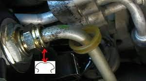

Actually you don't need the tool. Just pull back the plastic clip retainers off and then with a small screw driver pull the wire c-clips out of the hose adapter nuts and simply pull the hose ends out. They are the same design as on the transmission lines.

Actually you don't need the tool. Just pull the plastic clip retainers off and then with a small screw driver pull the wire c-clips out of the hose adapter nuts and simply pull the hose ends out. They are the same design as on the transmission lines.
Yep, I just use a pick to slide under the clip and then maneuver it right off!

I would advise making a flat spot, on one edge, of the tool. It looks like a top hat, knurled, along the outside edge. For the long line, there is no space, for the tool to fit, between the aluminum line and the plastic cooler baffle.
The tool is hinged. I would make the flat spot, where the tool splits apart. After it is properly installed, you will have enough space, to rotate it and release the oil line.
Do you just pull and slide down those light colored/white plastic clip retainers with your fingers? First.
