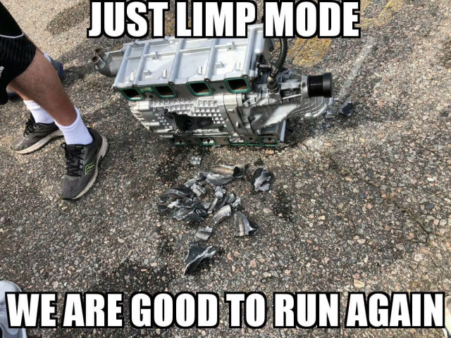

Well, I heard of 5 but it's probably more. " I have plenty of superchargers " he said!
The one I saw happen is the 1st picture and that SC blasted right through the hood and that Car which also had a brand new wrap on it! Totally grenaded, because he forget to turn off the NOS during a Burn out! The small shots like 150 is really max, But he was "Max effort", in seeing how many he could blow up.I think he holds the World record for the most blown up superchargers.
That 1st one the guys vacuumed everything up and he went home and got another one. They had that installed, but he missed his race and was done and out. But he got his very own Meme! I'll have to find the hood pic.

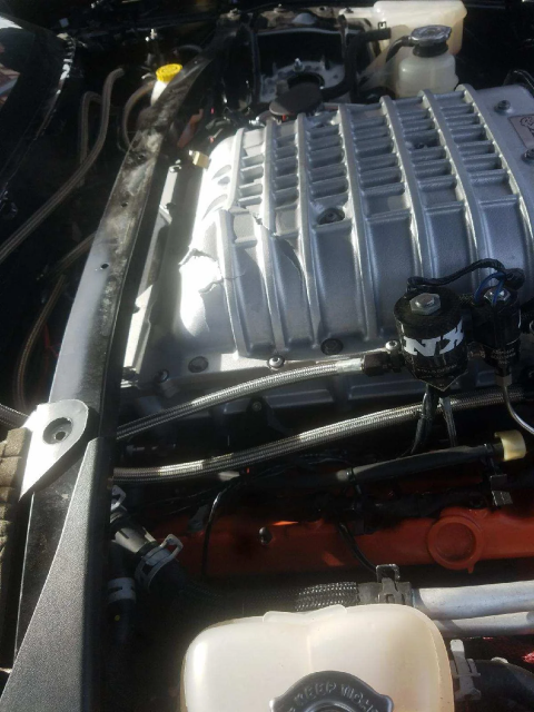

From another time Wrong NOS company for the Hemi cars too Nitrous Outlet is the better product to use.
And another time

There are other superchargers that have blown up from too Much Nos. But the World record has not been broken!
