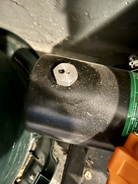

@2ndAmend Yup, aforementioned breather on pump.
