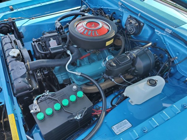

Are R-134a oils backwards compatible with the old R-12? I have a 30 lb tank of R-12 that I was going to use in my classic Mopar that I restored but have a reman compressor that probably has R-134a compatible oil already in it? 20190713_115559.jpeg

Are R-134a oils backwards compatible with the old R-12? I have a 30 lb tank of R-12 that I was going to use in my classic Mopar that I restored but have a reman compressor that probably has R-134a compatible oil already in it? View attachment 111660

Thanks WOHT. My system is all new parts. New compressor, a/c lines, evaporator and condenser are all new. It’s a rotisserie restoration. The Classic Air guys said I could use R-12 but I think I’ll go with the R-134a because the oil in the reman compressor is 134a compatible. I guess my tank of R-12 will be for sale at that point.
Not a problem. Yes, if your ac compressor is R134A compatible, then stick with R134A refrigerant. R12 will ruin your ac compressor based on what I read. Good luck with your project!
