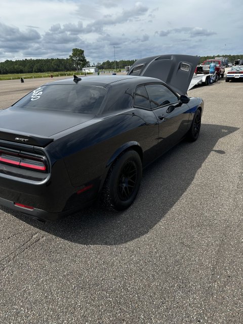

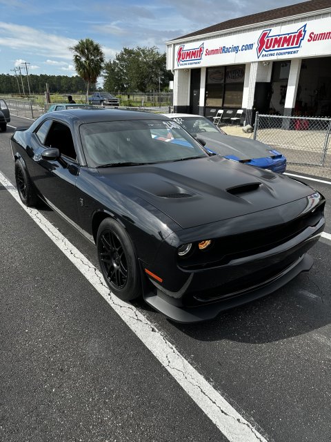

These are 315s standard body backspacing 10” wheel with a 14mm spacer/longer studs

I go back and forth on removing them all the time. I had a shop paint match them to the car. Have the front but took them off

Put some ppf under them and glad I did. Can see where the wiggle I guess under wind and vibration. These are on there pretty good with tabs and (gasp) magnets
