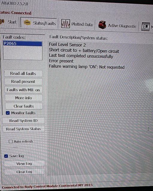

Hmm, so which one is #2? So this doesn’t show a CEL, gas light just flashes and “server fuel sensor” message shows on evic
5,560
4,600
Thread Starter #69
Tell me I replaced the wrong one 😑

Yeah. You did.

If 1 is A and 2 is B...1/A indicates driver and 2/B indicates passenger side according to what I'm reading.
