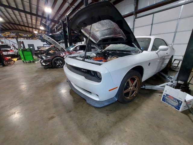

New PB, was looking for 9.5-9.6 and went 9.33 @ 149.23 8E6025E4-229F-4F9D-A2BD-F10BBABB9F85.jpeg

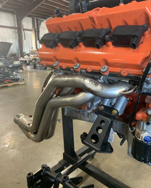

Have not posted in a while….we locked the motor up on Nov 26th at a test and tune. I have not opened the motor yet to see what happened. It locked up when I got out of the throttle at the beams. Of course my tablet was dead and I did not log that run. I ended up purchasing a complete engine that is a 426 and is suppose to be good for 30psi and 1600rwhp. Old engine should be out next week and then get the new engine in and tuned.
Since I have not been working on my car, I started on this project. It is on a 2005 Dodge Magnum RT, stock 5.7 engine. 948AD168-5DB7-4D8D-99EF-2BA46EF5D91C.jpeg 6297E48D-0BBB-4EE1-AE15-DE61E87AA973.jpeg

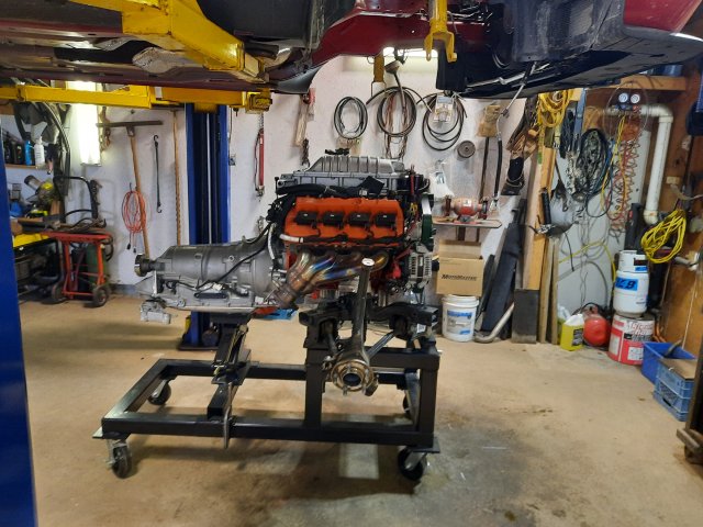

Old motor is out, may have this thing up and running by the end of the week. 344444C7-60B9-4FCE-AF04-82AA97BBA17D.jpeg

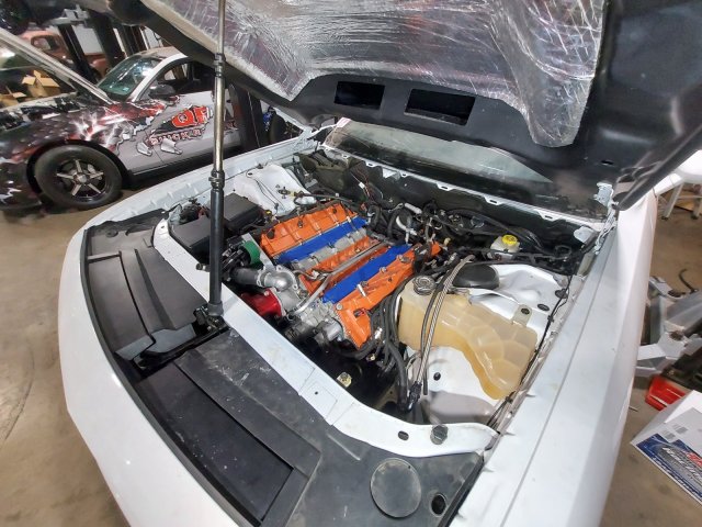

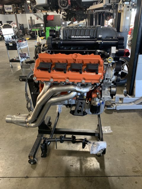

A little mock-up on the new motor, still waiting on a few parts to come in so we can get it installed and tuned. 707E1836-B95A-4C82-9278-1BD8468A5741.jpeg 1690B392-0651-4B95-B032-ED6A2BF9BE3D.jpeg 2E49E9AB-8012-48B2-8DB6-61F417EF76C0.jpeg 2D253308-0247-475C-8938-9182824A1F54.jpeg

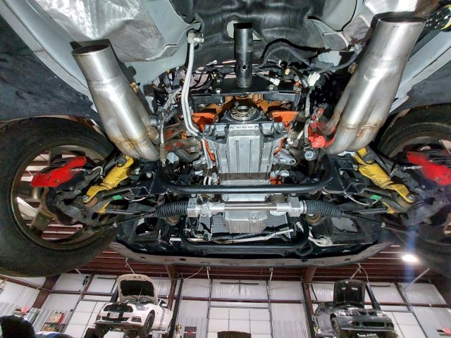

More progress, new cradle, manual steering and engine are installed. Still waiting on a few small parts to install the Magnuson and the new Sipple Built transmission. Got the cage set-in the car and will start the install today.
45FB2BD5-DCFA-4C43-81D9-1A0EC8951F31.jpeg 73D0F01E-8E0C-4205-940F-AE804F12BF50.jpeg 325A8FD8-6921-4254-9870-26DFD38634D4.jpeg 3518926A-6522-4C1F-89A9-9650B14DA536.jpeg 916E4B28-6AE7-4A9E-A931-6D6A739EFEEB.jpeg 7B2E7CB6-05B6-44B4-8B36-ADE1E75E4076.jpeg
