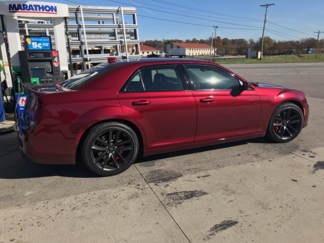

I agree about the CD players. NO station on my car radio will play three songs in a row, that I like. I purchased all the music I really like in CD format. I could change out 6-whatever discs, every time I take the Cat or my 300C out. I have probably 3-400 CD's. in my shop, to choose from.
I'm gonna be looking into a trunk-mounted changer setup....for sure in my 300/roadcar. I took a 12-hr roundtrip in it in the fall. The only thing lacking, was decent music. I end up listening to AM talk-radio.

Screw that. Can you even buy a CD changer anymore? Take one of your old phones, rip your CDs, copy them to the old phone and use it as a music player in your car.
