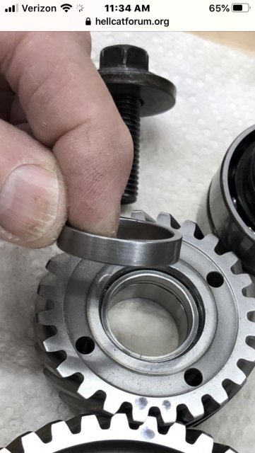

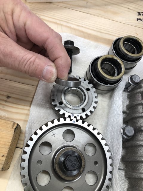

Here’s for all you guys running a solid pulley, this little washer is the only thing keeping the idler rotor in time with the driven one. The gear is NOT a press fit on the shaft either, it’s a slip fit and held in tension by a left hand bolt. The bigger gear is a shrink fit, it’s not moving, but the little one’s not got a whole lot holding it in place and it spins faster then the driving gear and is about twice it’s weight, ALLOT of inertia going on here to change speeds in a instant driven by a solid hub pulley. I won’t run one.

Exactly, that’s why they put a clutch’d pulley on that supercharger and why no one that rebuilds them such as John Bond warranty their rebuilds if you use a solid pulley and they could tell because only way they could get knocked out of time is a quick speed change and a solid pulley is the only thing that will do such. That little spacer ring is how you set the timing between the two rotors, So what do you think happens if it gets knocked loose?

Good info @16GoManGoHC2 & Thanks , but trying to rap my head around the washer & timing the rotors ?.....are you saying if the bolt comes loose the timing will be off (obvious) ?....not really the washer ?

If the bolt comes loose the only thing driving the rotor then would be the other rotor as the little gear is just a slip fit on the 3 line rotor shaft, it relies on clamp force to drive it, no keys, no splines, just like the harmonic damper. I think it would make lots of noise if that happened. The 3 lobe rotor is adjusted to the 5 lobe one to center itself between the lobes so they don’t touch one another, there’s about .008” clearance between the 2 and it can be adjusted back and forth ever so slightly to close the gap on the pressure side of the flight and I think that’s what makes one SC make a bit more boost then another, how that gap relation is set. But get it too tight and they’ll rub just like in the picture at the beginning of this post. Something made my original blower make 17psi of boost with a 2.85 Litens, my spare blower only made 16.5 with same snout and pulley. That’s the experiment in this project.

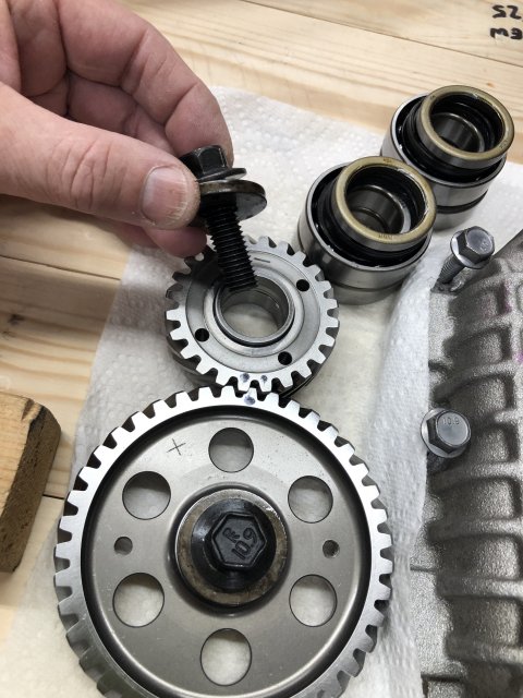

O, the washer is just a spacer, maybe I should have called it such, it sandwiches between the clamp bolt washer and the gear which then clamps the gear between the bolts washer and the rotors shaft against a shoulder, got it now?
This thing
This thing
Do you know the torq spec on the rotor gear bolts ?....Loctite would help since your there.

Nope, it’s getting impacted lol
But yes some blue loctite would be advantageous, I use loctite products often, have an arsenal of their products at hand always.
