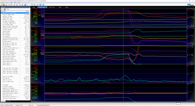

@Speedy! I've been down this path, unfortunately it's yeah run the BAP or upgrade to triples. For my experience when OST was tuning the car when it died at the 660, that was it. For reference here is a wot pull for me at ~20psi.
I am commanding 80psi but giving it 94psi, I should probably back that off at the regulator to 85psi (give it some head room). In some of my other tunes when I was running 104/93 mix it was commanding 94.3 to give it some head room. Since I've reset a lot of those tables that is an artifact. However my FP DC is barely up there. Plenty of room left and the injectors are barely sneezing. (This was a fifth gear pull, and I was only testing to make sure the trans was ready to rock n' roll).
