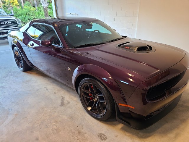

What kind of succes or lack of have you had with ceramic coatings?
Do you think that it's worth the expense?
What do you suggest ILO ceramic?

I have had good luck with it so far. I have not had it done on a vehicle that did not need some polishing first though so my cost has been over $1000 for installation. Opticoat Pro is what was installed on both vehicles. The truck was used daily and sometimes in some dusty/muddy areas and 3 years later it still looked good.

Had mine done from new, the key is meticulous preparation ,had it recoated after three years .I would 100% have it carried out again
All lI do to clean is snow foam/shampoo/ blow dry and finish of with a microfibre cloth.Takes about an hour and looks like I’ve spent the weekend detailing .

I had my first 3 Challengers professionally ceramic coated. First was my 15 HC I bought used with 10,000 miles on it. It was well taken care of by its owner and was PPFd on the front bumper, fenders and hood, but was scratched and abused by dealership lackey car washings. Paint correction fixed a multitude of sins in both the paint and the PPF, and the car looked amazing when done. I owned the car for 2 years and it spent its entire life with me parked outside and went through one winter covered where I didnt drive it. Looked like the day it was done when i sold it.
2nd car was my 2018 392 T/A. Ceramic and color corrected. That car also sat outside 24/7 and I drove it daily through 2 salty/cinder-y PA winters. 52,000 miles. I had zero issues with taking care of the satin bits on the top of the car, and after the 50k I had maybe 3 nicks in the hood. Otherwise, zero issues and the car looked brand new when I traded it. I DID go back once for the ceramic installer to clean the car in spring after the first winter. Maybe they refreshed it, I dont recall. But when I sold it, again it was in amazing condition.
3rd was my 2019 1320 this one was garage kept and driven 18,000+ miles. Car was pristine when I traded it.
All in all, it was $$$$ to do, about $1,200 each time for each car to be corrected and ceramic-d but they were rediculosly easy to take care of and always looked like they just came off the showroom floor. In hindsight, yeah bit of a waste of $$$$ since I didnt keep any of them, BUT if you do, IMO well worth the price to keep your car looking its best as easily as possible. FYI no one gave a shit when trading the car in or selling it.
I now have an 18 Indigo blue HC that could hugely benefit from paint correction and ceramic but Im holding off for a bit to see if I end up keeping this one.
If you love detailing cars then do it yourself. Im 55 and TIRED of slaving over the paint and condition of the car when it comes to cruise ins and car shows. Ive been doing this since I was 18 and FK IT. If there is an easier way IM all for it. Professional color correction and ceramic is worth it to ME. Your Mileage May Vary. (YMMV)

Timely thread for me since I've been working with mine of late. I shot some content on it yesterday that will probably go up next week.
Short answer - Ceramic is 100% worth it if you want an easy to keep clean car that looks amazing all the time, but I'd consider a DIY product as things have improved in that area since I had mine done professionally.
I also had PPF (Xpel was the brand) applied to the front end of the car, and the mirrors. Ceramic was then applied over the PPF making it super easy to knock off the bugs. 5 years down the road I have almost ZERO paint chips, like count on one hand, and the PPF is still in excellent condition. If I had it to do again, I'd have had PPF also installed behind the rear tires.
If the paint is scratch/swirl free then I'd just wash it in dish detergent to remove any previous wax (I'd use Dawn).
Then clay bar. You might consider the Mother's Speed Clay 2.0 (it's a synthetic clay like sponge and may be a little softer on the paint)
Speed Clay 2.0: https://amzn.to/3GOBM5X
Then wipe it down with panel wipe: https://amzn.to/3MoHWe2
Finally apply Crystal Serum Light: https://amzn.to/39729ra
The entire process above would take 90 minutes tops and be good for at least 3 years (that's where I'm at on the Mrs. car so far).

I had the Hellcat professionally ceramic coated in September of 2017. The product used was Gtechniq Crystal Serum which had a "guarantee" of 7 years, supposedly longer if garage kept. I had it done just a couple of months after purchasing the car. Installer surveyed the paint, determined it needed very little paint correction, and knocked the price down from $1000 to $600 as a result. He polished 2-3 little areas where he saw a blemesh or two, and applied the ceramic. Most of the labor is in the paint correction, so keep that in mind. If you apply ceramic over scratches and swirls it will seal them in.
I have been THRILLED with the results. My goal was to reduce the time it took to clean the car as much as possible. I've not really done anything special to take care of the ceramic and in fact treated it pretty harshly over the past 5 years running it through a touchless car wash several times a year and only hand washing the car a few times a year sometimes going 6-8 months without washing it at all. I'd just spot detail the front to get bugs off, and behind the tires to remove any road grime using Ech20 mixed as a detail spray.
The Ceramic has 110% made keeping the car looking fantastic super easy.
I wanted something similar for Mrs. Speedy's ride, but didn't wanna pay $600, so we went with the consumer version of the same product professionally used on the Hellcat.
This is what I used: https://amzn.to/39729ra
Her car was also new, the paint was in great shape, so all I did was clay bar and use a product called Panel Wipe (https://amzn.to/3MoHWe2) to prepare the surface and applied the Crystal Serum Light. That was 3 years ago and her car is still slick as glass and looks amazing.
I recently noticed "something" on the hood, roof, and trunk of the Hellcat that had a roughish feel to it. Paint still looks amazing and water beads/sheets right off but the top doesn't feel near as slick as the sides. I probably should have been doing a better job of hand washing to prevent it rather than going months and months but live and learn I guess. I'm going through some steps to resolve it, none of which have bene labor intensive, but I always start with the least invasive and work my way up. I expect to have it 100% by the end of the week and I'll let you guys know what I had to do.
4,053
16,241
One thing I would add to the above - be VERY careful when using Dawn to wash your car !!!!!!!!!!
It is the recommended soap to prep a car for any sort of coating because it strips off all the old wax/sealant, which leaves the surface VERY vulnerable to EVERYTHING !! Be sure the car is cool when you start & do the wash in a very shady spot - do it in the sun & you will be hating life !! Fully dry the car before proceeding to the claybar step.
All the following steps (clay, polish, wipe down, coating needs to be done in the garage/carport or somewhere the car will be protected from any sort of fallout/contamination until the final coating has fully set (time varies depending on product).
