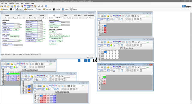

Some interesting results from today's parking lot tests. I started out by doing a diff of the 2018 Hellcat A8 file and applying all column and row axis values to the following launch control tables:
[ECM] 47501 - Launch Control Torque Reserve (Slow Path)
[ECM] 9962 - Launch Control Fast Path Proportional Term
[ECM] 9959 - Launch Control Slow Path Minimum Error To Enable
[ECM] 9960 - Launch Control Slow Path Initial Torque Reduction
[ECM] 9961 - Launch Control Slow Path Initial Torque Reduction Multiplier
[ECM] 9957 - Launch Control Slow Path Proportional Term Multiplier
[ECM] 9958 - Launch Control Slow Path Integral Term
I wrote the tune and then drove to the local school parking lot, just my luck a little league game was going on... fak!
So I pull into the lot on the other side of the field far away from people.
Left it at 2000 RPM for the first test, made a whopping 6PSI of boost... Started to spin. Also got scared shit less cause of the way the wide bands sensors were knocking around. Here is a screenshot:
I undid the work. Although I didn't spin in 1500 or 1750 rpms I realized that the row and column axis modifications might not be worth it for me they were also wildly off. So I decided to go a different route. Currently heading back to the spot, having a moment of genius.
