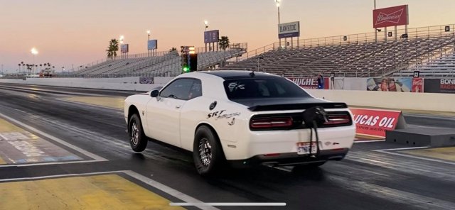

Some of my thoughts... I prefer to use the more gear/more tire combination. By “more” I mean taller. You don’t want a taller tire with the 2.62. It’s too much. So you’re sacrificing that additional traction you can get with more tire due to that 2.62 gear ratio. I know some get better results with the 2.62, but those are super high hp cars that can pull that higher gear. Even they are using the 28” tall tire because the 30” is harder on the driveline with the 2.62. Speedy.... your car is not in the high hp category by comparison. I think you would benefit from the 3.09 with the 315/50-17. With my pulleyed stock motor (9.50@145) I was running low 1.40 sixtys with that tire/gear combination. If you don’t want to go that route yet..... the single biggest thing is alignment to get what you’ve got square and flat on the track coming off the line. To do that you HAVE to have adjustable control arms with stable bushings. Whether you can go with the top of the line (expensive) AAD Drag Set or something else (Spohn, BMR or whatever)... you need that zero toe/zero camber setting when the car transfers weight off the line. I think springs help with the initial weight transfer but I think alignment is more important. You can’t hook up if you’re only using part of your tire.
oilburner
#1135
690
1,745
coboconk
anybody have any idea how much these cars squat on launch?? I want to add weight to lower back before alignment. already done all the good stuff back there .AAD, BMR, DIRS, demon springs etc. doesn`t look to be much when you watch these cars leave the line. 1/2 inch ?? :unsure:
3,306
10,512
You’re right. They don’t squat much. Maybe one inch max. After observing this.... I reduced my positive camber to a .3 degree setting. It just doesn’t change as much as I previously thought. I would suggest anybody that also drives on the street or doesn’t leave that hard just go with a zero toe/zero camber and be done with it. This is what a 1.3 sixty looks like and the fender doesn’t even come close to being on the tire. 40DDFA35-83A2-4C38-9E61-07A2FF155DFF.jpeg
