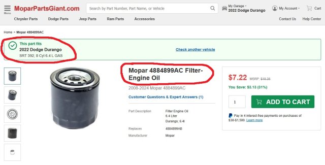

Ha! Did not want a new thread. This is a random question. WTF is Mopar telling these dealers?
Here for an oil change (sorry that filter is too much of a PIA to get to) and these guys say the SRT filter is not for a 6.4. I told him to install one anyway because if I were changing my oil that is the one that goes on it, so make it happen.
What is an "SRT" oil filter?
Which one did the dealer want to use?
I checked the invoice for my recent oil change, the dealer used part #4884899AC for the oil filter.
So I went to MoparPartsGiant.com and looked up the oil filter for my '22 Durango SRT 392 6.4, it's the exact same one the dealer used:
https://www.moparpartsgiant.com/parts/mopar-filter-engine-oil~4884899ac.html
