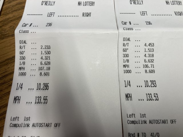

20HCM6 22RENBS2
1.5's in the 60 with LC.
