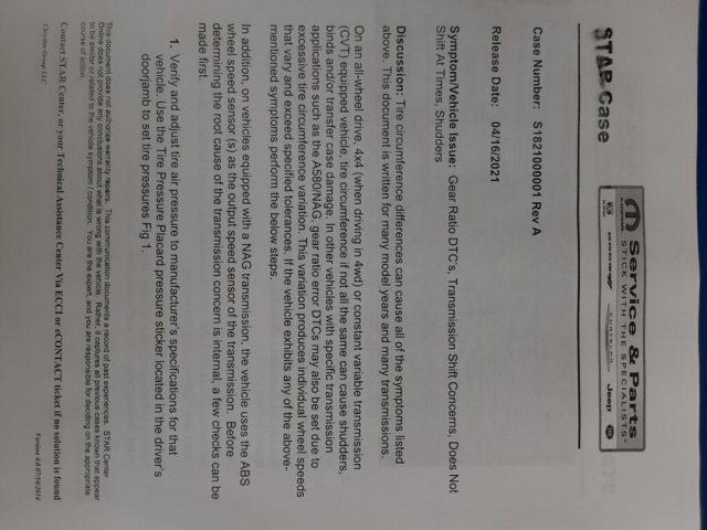

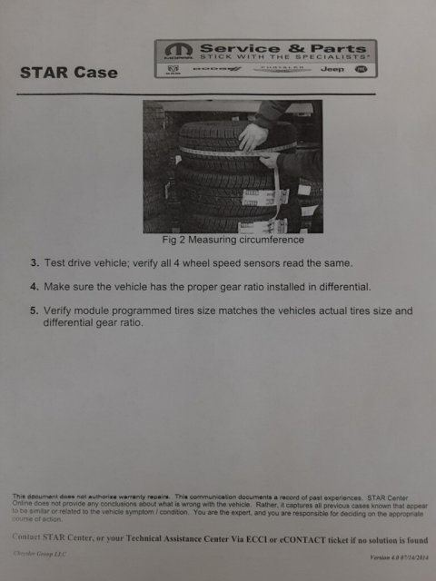

So @DodgeCares here is a print of that STAR whatever. I have a pretty good Dodge connection at my dealer. We got this info today.
You let us know how this relates to these three pages of discussions of REDEYE shifting hiccups please.

^^ This says Alfa Romeo Giulia....not the L series platform of Dodge?
Hi 2fast4u,
This is correct. The TSB number was not for Dodge vehicles.
Rob
Dodge Cares
Hi DGatzby,
When looking up transmission shudders, "hiccups", in our internal service system, we can see this STAR case as a potential resource. Transmissions have factory programing that is calibrated to stock wheel/tire size. We understand that some members of this thread don't have stock wheels/tires.
Rob
Dodge Cares

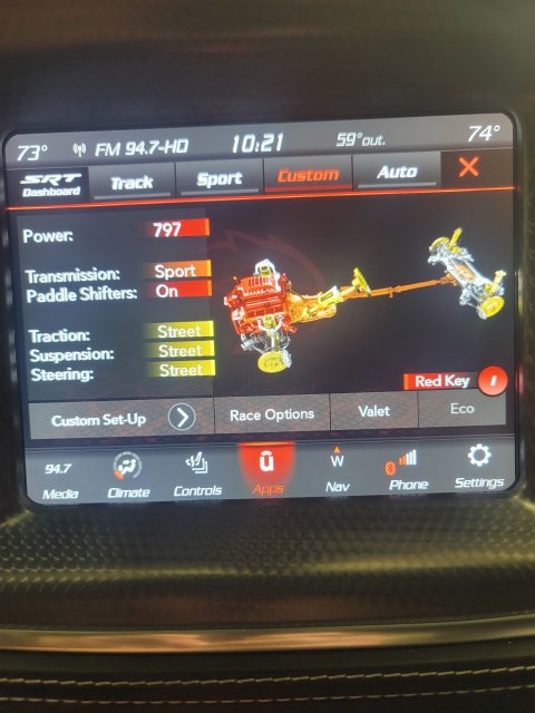

#55
With street tires I have been told the problem is that the tires are spinning and the computer has no parameters for that condition, so there is a lag in the shift.
But I'm running M/T 305 45x17 at 18 psi on a prepped track. I cannot tell if they are spinning after leaving the line. My best 60 ft is 1.51. I am still trying out different settings for my custom mode. I am getting some wheel hop occasionally that I cannot figure out and I have the DIRS diff support. M/T reps said to increase my tire pressure to 20 lbs but I have not been to the track since to try that out.

#56
If you are getting hop that is a good sign to increase tire pressure. Many members on here run over 20psi. If you are on really good prep then yes 20 to 21 psi. If I was you try the 19.5 - 20 range to start and adjust from there.
As for custom settings
trans track
suspension street
traction sport
Oops....that picture was my street custom setting. My dragstrip settings are:
Trans - track
paddle - on
traction - sport
susp - street
steering - street
