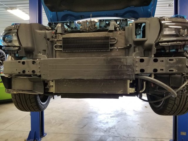

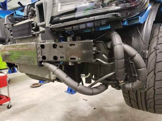

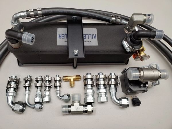

Just grabbed a Killer Chiller race drag system to cure IAT/Coolant temps. Not sure about adding the bigger reservoir. Might see how temps look before deciding if one is needed- unless ya'll that have one on a 4.5L know better.

Car arrived safe last week (y) rode with a Tesla Model S P100d. Bet that was an awesome sight to see drive down the highway. No update if it needs a converter.
View attachment 25043 View attachment 25044
View attachment 25041 View attachment 25045

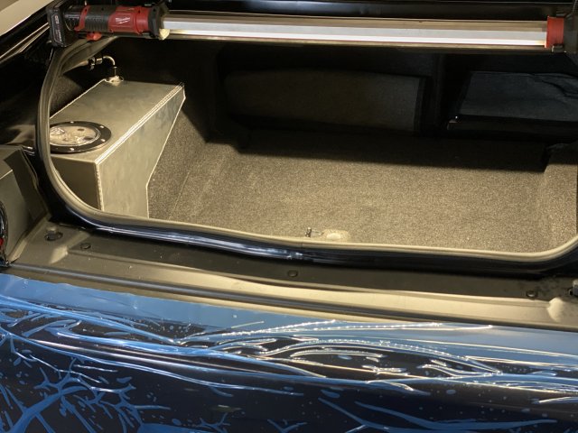

Highly recommend adding a reservoir, 1.5 - 2 gallons is ideal for 1/4 mile.

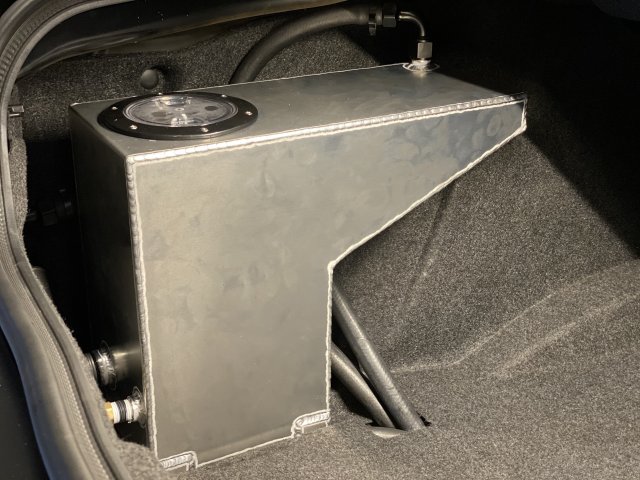

Agree. I went this route because with the shape of this tank, I can run that 2 gallons without uncovering the pump intake and I have the option of still using ice at the track. 72F19AA2-6F5F-4309-A895-EC6AEF1011C1.jpeg

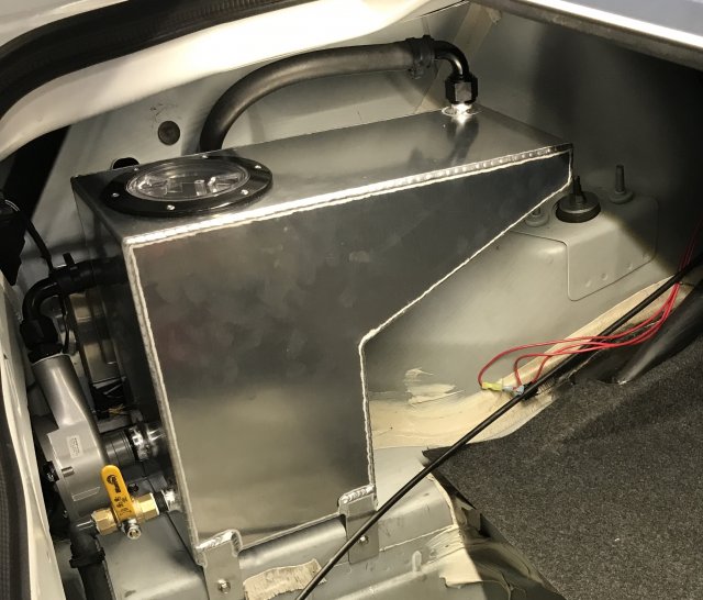

I run a 2 gallon Gearhead tank in the front bumper. For $300 bucks it’s a great fit

Do you happen to have any pictures of the gearhead tank setup?
FFBOS
#1008
692
1,180
Mount Prospect
2016 Hellcat Charger
Yes 665DDE57-1429-4E20-A4AD-1F27F6936FB8.jpeg B0B8DC19-3FA0-4F60-81D4-074F4177725E.jpeg 88B32CA3-E0D0-49FE-A163-54D4131EB99A.jpeg

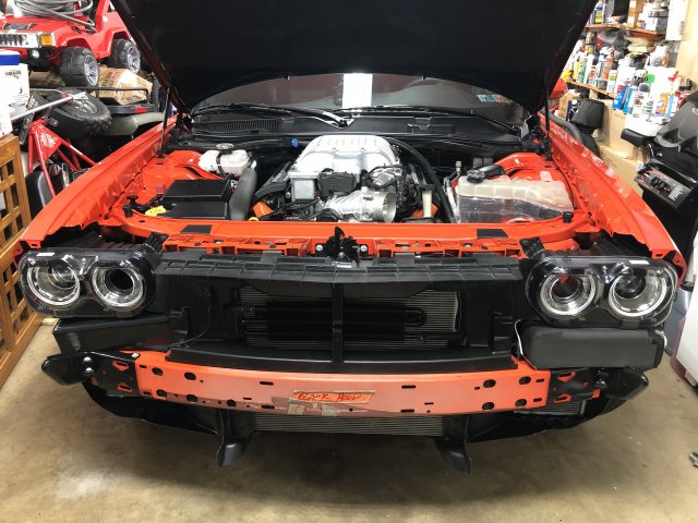

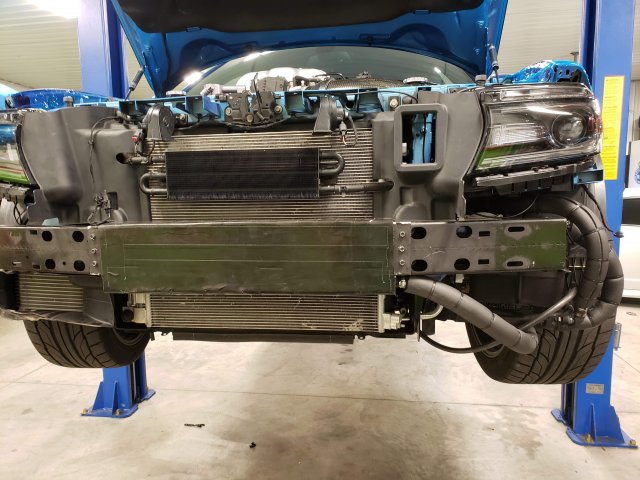

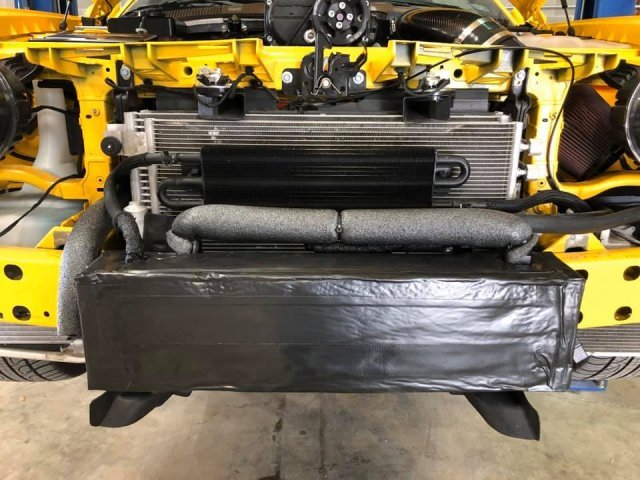

Wondering if the 13" 'race drag' version will fit in the same location. Going to check what the shop wants to do before ordering the Gearheadfab tank.
I like how 16GoManGoHC mounted the 14" chiller under the driverside light. Also made a custom 1.5 gal reservoir to go under the passenger side. Very clean install.

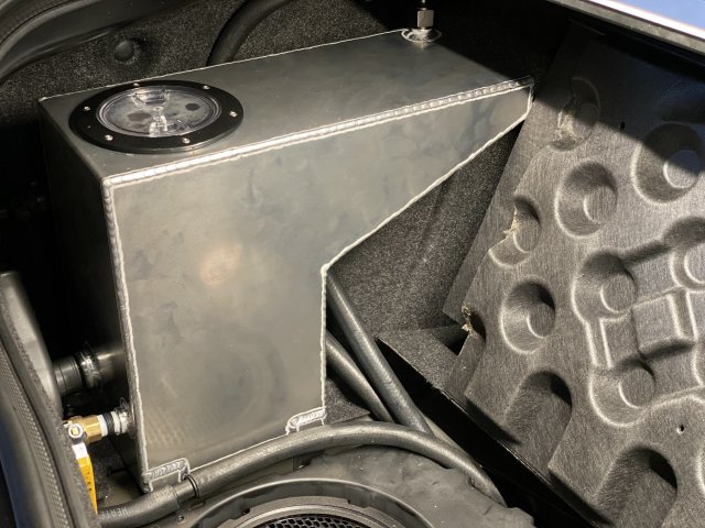

Check this out. Custom install by SRT AutoWorks.
We can load this bad boy up with lots of ice.
No need to remove sound system with this set up.
Easy to fill up too
4F4EFF5A-83AC-4061-9FAF-63AF0232529C.jpeg C1B1ECC9-7FBB-4B38-96CD-3106E108A7E3.jpeg 56EC364E-0A39-4BE0-8B75-2B5CBCB4BCF7.jpeg
