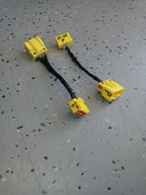

This is the first time I ever made a set of these. What are they?

You have me intrigued
You can use newer Challenger seats in an older Challenger and all the airbag stuff will still work. Years are on the connectors. On the driver side I passed through the Power and Ground so the power driver seat will still work (but no heating or vent etc.)
