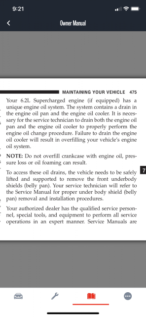

So on every other oil change you'll have 7.5 quarts of oil in it. The oil cooler should be drained every oil change, my .02

It's about 1/3 qtr. in the oil cooler , just saying it will be more than 7 if you don't drain the cooler.

The Owner’s manual says to do a correct oil change the cooler should be drained each time the oil is changed . It makes no since in my mind to not drain the cooler each time . But to each his own . 86031BAD-5D57-4B42-ADE9-366978F5E36E.png

Don't bring pesky facts into this debate, please.

Get this to solve that issue https://oilcooleraccess.com/

I just cut a hole in panel right where the oil cooler drain plug is , so I don't have to remove that panel , I just remove the panel for the oil filter & pan plug , 4 bolts that it much easier .

^^^^ Just make sure the cut out is just big enough to get channel locks or crescent wrench on it to hold as back up on that drain line as you break lose & tightening the plug , you don't want to bend or break the drain line tube !

I use a regular wrench, which also works quite well.

Yeah , what ever works for ya , point was to use a back up , happy motoring !
