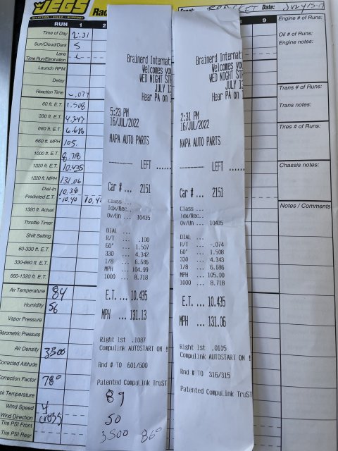

With no weight reduction and DA at 3300 feet that’s about right.
I added the Demon safety harness 38lbs
Clothe interior
With Passenger seat
4,354
10,812
